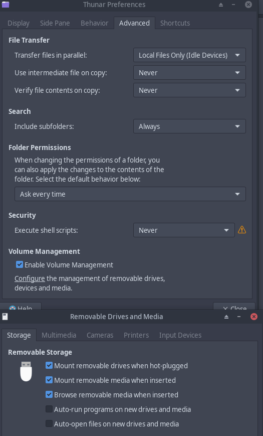

I rechecked Thunar-settings-volume Management-advanced-clic configure-camera checked the box, All good… I am lost.

Edit / Preferences / Advanced
I tested with plugging an SD card only.
Hii and thanks for the replie.
My $ yay thunar | grep Installed 6 extra/thunar-media-tags-plugin 0.6.0-1 (67.1 KiB 309.6 KiB) [xfce4-goodies] (Installed) 5 extra/thunar-archive-plugin 0.6.0-1 (41.2 KiB 175.6 KiB) [xfce4-goodies] (Installed) 2 extra/thunar-volman 4.20.0-2 (131.7 KiB 671.6 KiB) [xfce4] (Installed) 1 extra/thunar 4.20.4-1 (1.5 MiB 9.3 MiB) [xfce4] (Installed)
And Preferances are set the same plus camera settings as noted above.
