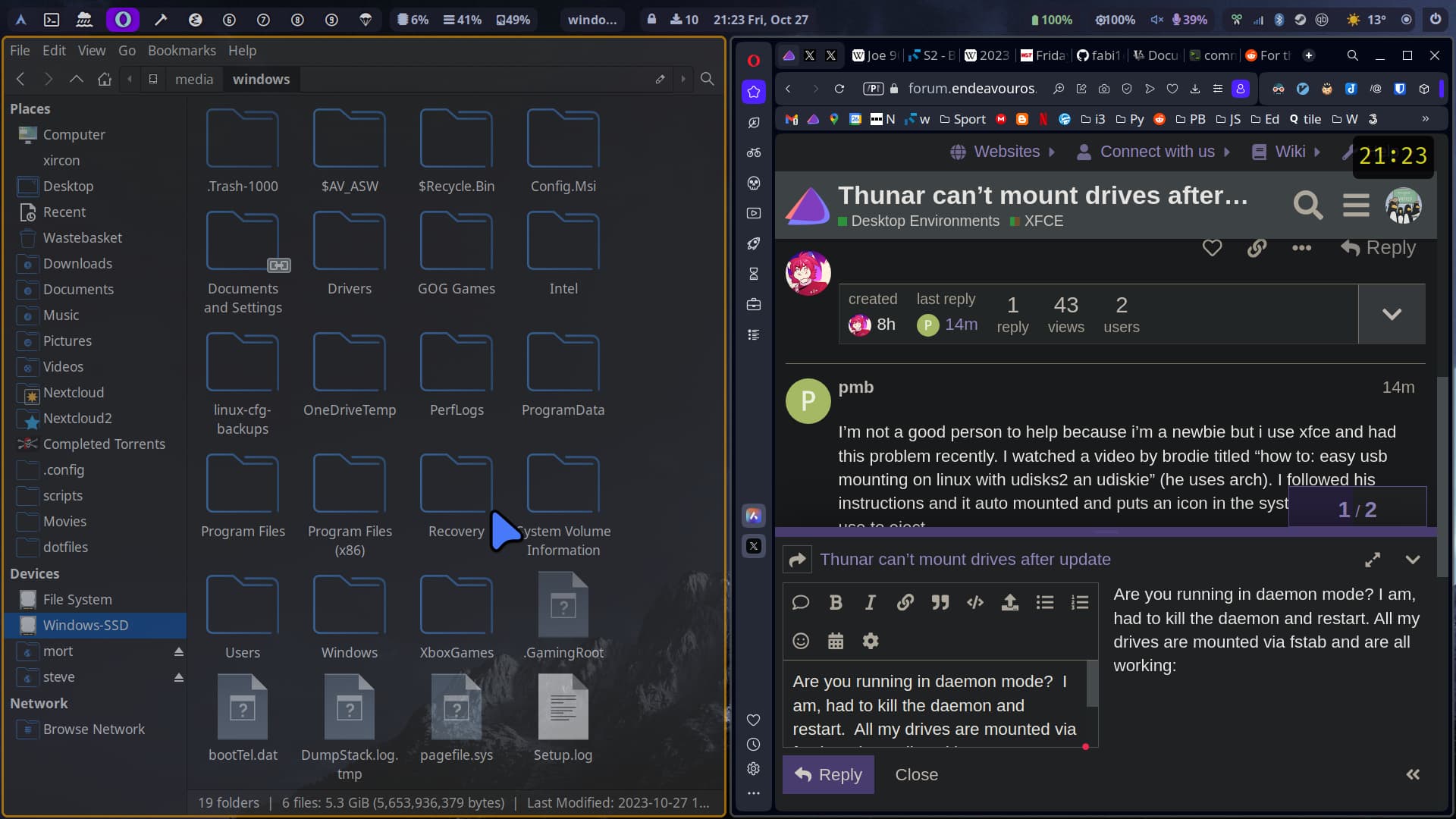

I’m not a good person to help because i’m a newbie but i use xfce and had this problem recently. I watched a video by brodie titled “how to: easy usb mounting on linux with udisks2 an udiskie” (he uses arch). I followed his instructions and it auto mounted and puts an icon in the system tray you can use to eject
Are you running in daemon mode? I am, had to kill the daemon and restart. All my drives are mounted via fstab and are all working:
Windows and an old WD my cloud.
Am I running what in daemon mode? gvfs? Thunar? Something else?
The system is however it comes when you install it, which is why I’m asking for help here. It broke without me touching it, and reinstalling gvfs did nothing.
Mounting via fstab is fine - for fixed disks. But flash drives exist, and it’s be great for them to just show up in the file browser when I plug them in, like they’re supposed to do.
Thunar.
Run this in a terminal:
ps aux | grep -i thunar
E.G:
xircon     99281  0.3  0.2 757100 33960 pts/4    SNl+ 19:56   0:31 thunar --daemon
With no thunar windows open:
kyle       68798  0.0  0.0   6552  2416 pts/0    S+   22:32   0:00 grep -i thunar
So no daemon.
