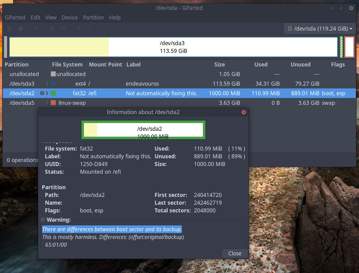

SHORT VERSION WITH TWO QUESTIONS AT END: So I’m routinely inspecting free space amount and clutter, a twice-a-month thang. I prefer to use the tool gparted for this. I see mouthy gparted telling me it’s not going to bother to fix an error-
so I type in search term, research, read 58 posts from the smartypants at superuser

Expected behavior: this would fix my ‘harmless’ problem
Actual behavior: despite reboots I can run this command over and over with the same result. “dirty bit” doesn’t get fixed, nothing gets written, fsck in a loop. Gparted? Looks identical to picture every reboot.

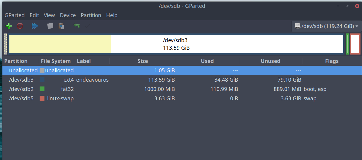

–Before judging i installed I have no idea how this starts at 1 GB unallocated partition…I was sober for this so I never remember anything..

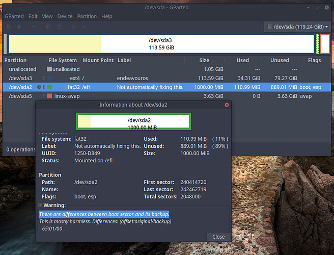

I just checked mine with gparted. I use grub not systemd-boot btw.
Edit: Here’s a better view.
Edit: Seems like it shows similar info?
that is very interesting, thank you.
it’s the “mostly harmless” message that gets me.

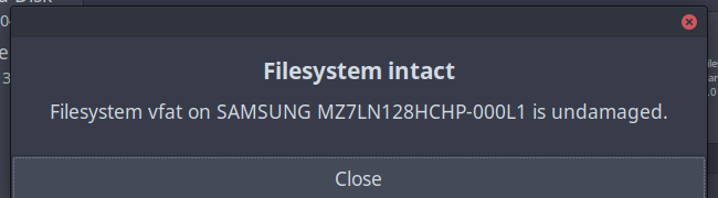

I was considering this a theory as well. In fact I took a cue from you and inspected the Endeavour with my partition manager, gnome-disk-utility.
Like your kde, it had nothing to report. It very well could be a bug in the way Gparted reads it.

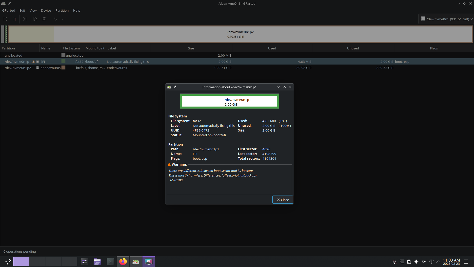

Hi, is there any update on this? I’m getting exactly the same warning in GParted. Is it harmless, and is this something that everyone gets?
