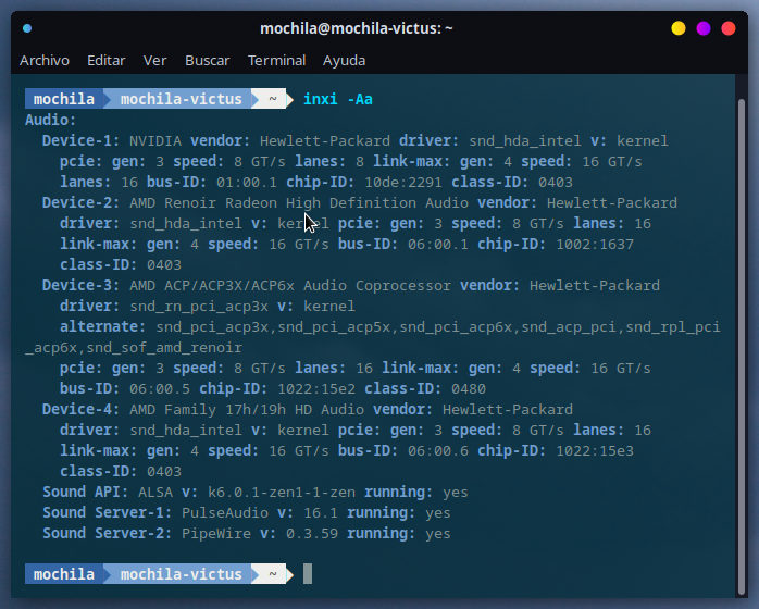

what says inxi -Aa ?
Latelest change to pipewire causing some issues ion some systems… caused by what they changed when adding pipewire-audio package
Captura de pantalla -2022-10-13 19-14-58

so seems you do have PulseAudio installed i would proceed to replace it with pipewire-pulse to get pipwire take control what should solve your issue—
