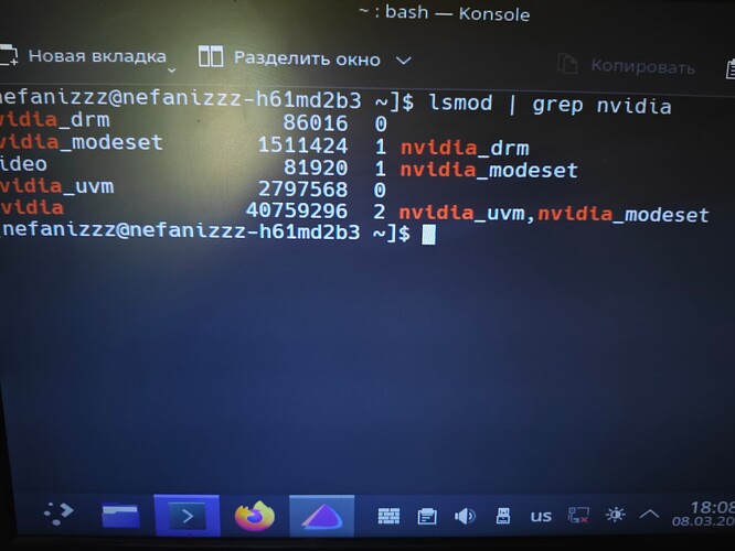

When I write “lsmod | grep nvidia” gives it away (photo)

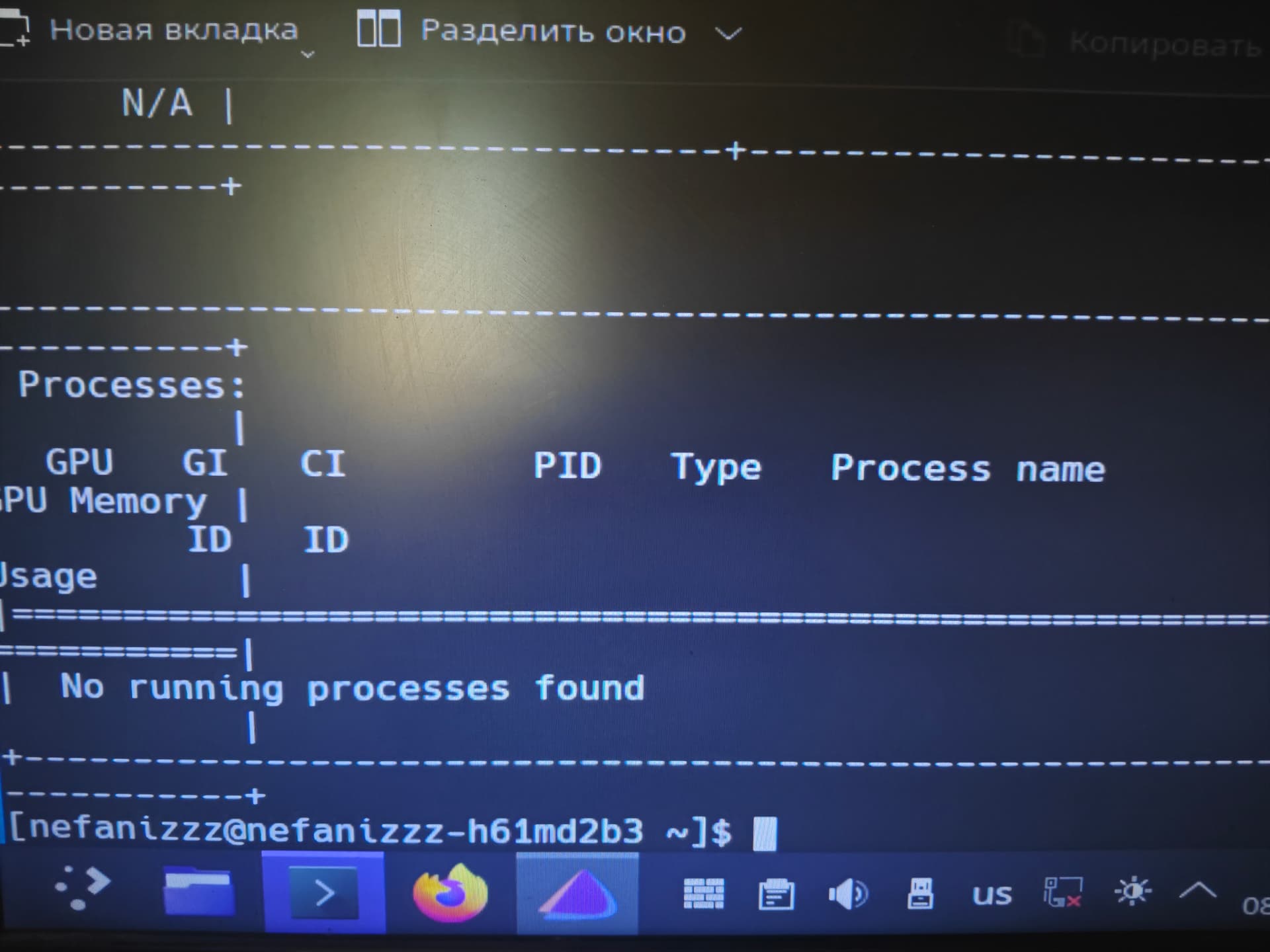

When I write nvidia-smi gives out that no running processes found
Help
