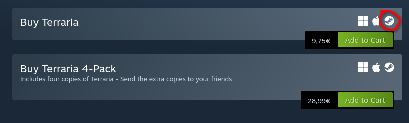

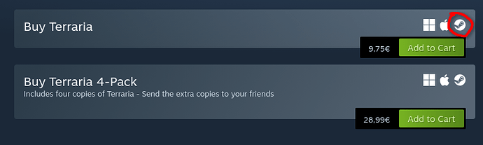

oh my god im an idiot there’s a NATIVE LINUX VERSION I didnt know that oh my god
It’s okay, shit happens. From now on, if you see this logo on a store page on Steam, it means that it has a Linux native port.
