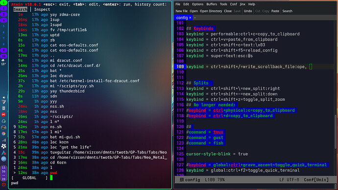

Also can I recommend Atuin for shell history, it is amazing:
It is in the repos.

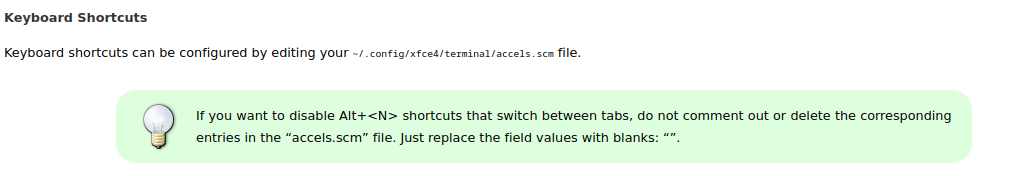

I’ve found out that a lot of the commands I was looking for are bash commands, listed here https://ss64.com/bash/syntax-keyboard.html . But now I’m more curious about what the XFCE4 terminal can offer, as I thought I was using the default bash terminal this entire time.
I found out that it is xfce4-terminal emulator through https://discovery.endeavouros.com/window-tiling-managers/i3-wm/2021/03/ (Incredibly useful, ashamed that I didn’t properly go through this earlier) which links back to the xfce4 terminal website https://docs.xfce.org/apps/terminal/start that shows
but the /terminal directory doesn’t exist, instead I have ~/.config/xfce4 (This is where the /terminal should be but it’s empty other than → )/xfconf (empty other than →)/xfce-perchannel-xml
xfce-perchannel-xml contains:
thunar.xml , xfce4-desktop.xml , xfce4-terminal.xml, none of which contain shortcuts.

I’m on XFCE here, but cannot find this file, too.
But, if you start your (xfce-)terminal, goto Edit → Settings → Shortcuts (translated from my german terminal, take care…) and you get a huge menu. No idea, where it gets stored.
Edit: just changed 1 default and got this accels.scm. Try that!
Seems, the defaults are in /etc or somewhere…
