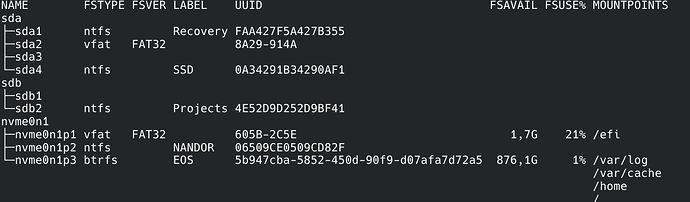

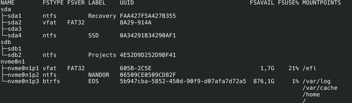

Post the output oflsblk -f
Thanky you! Here is a screenshot.
I gather that the Windows EFI partition is sda2 and the Linux one nvme0n1p1.

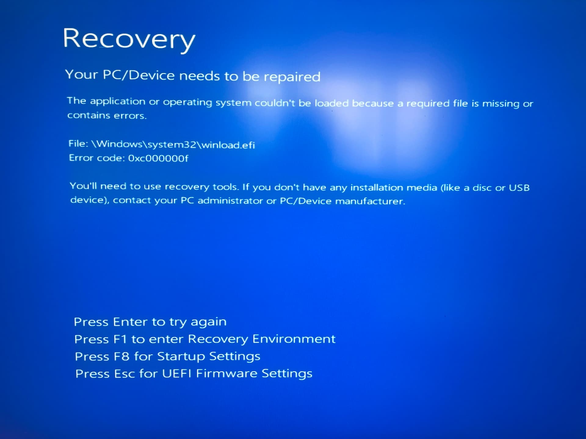

I did what you suggested, but sadly it still does not work. I get the blue recovery screen when I choose the Windows 10 entry in systemd-boot.
When I press F8 it suggests that a file is missing or corrupt but I am not sure that this is really the problem here but rather a result of incorrect linking.

But there error:
Error code: 0xc000000f – \Windows\system32\winload.efi
Say it is not able to find the file.. so may issue is differently

Yes, like I said, I can boot into Windows from Bios.
And I somehow do not believe that this file is truly missing, since I haven’t changed anything in my Windows installation and the multiboot worked perfectly fine with GRUB.
I saw such screen too on my testings and yes the file is not missing as of windows is working. Must be somehow it does search wrong path for me using windows.conf was working with correct title and ego lines
