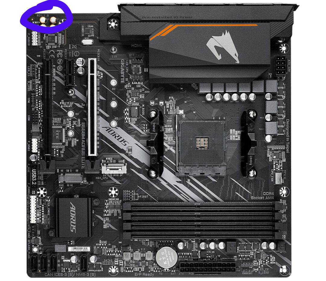

B550 AORUS ELITE AX V2/B550 BIOS FEc 09/20/2023
I noticed your Bios version is odd. I don’t see that version listed on the site and there are board revisions 1.0, 1.1, 1.2, 1.3, 1.4. and 1.5 so I’m not sure which Bios update is applicable for your Motherboard. It would seem though that there should be a newer version available.

How do I know if my motherboard is rev. 1.0, rev. 1.5, rev. 1.4, rev. 1.2/1.3 or rev. 1.1?
Maybe not the easiest, but definitely the safest, way is to physically check on your motherboard.
