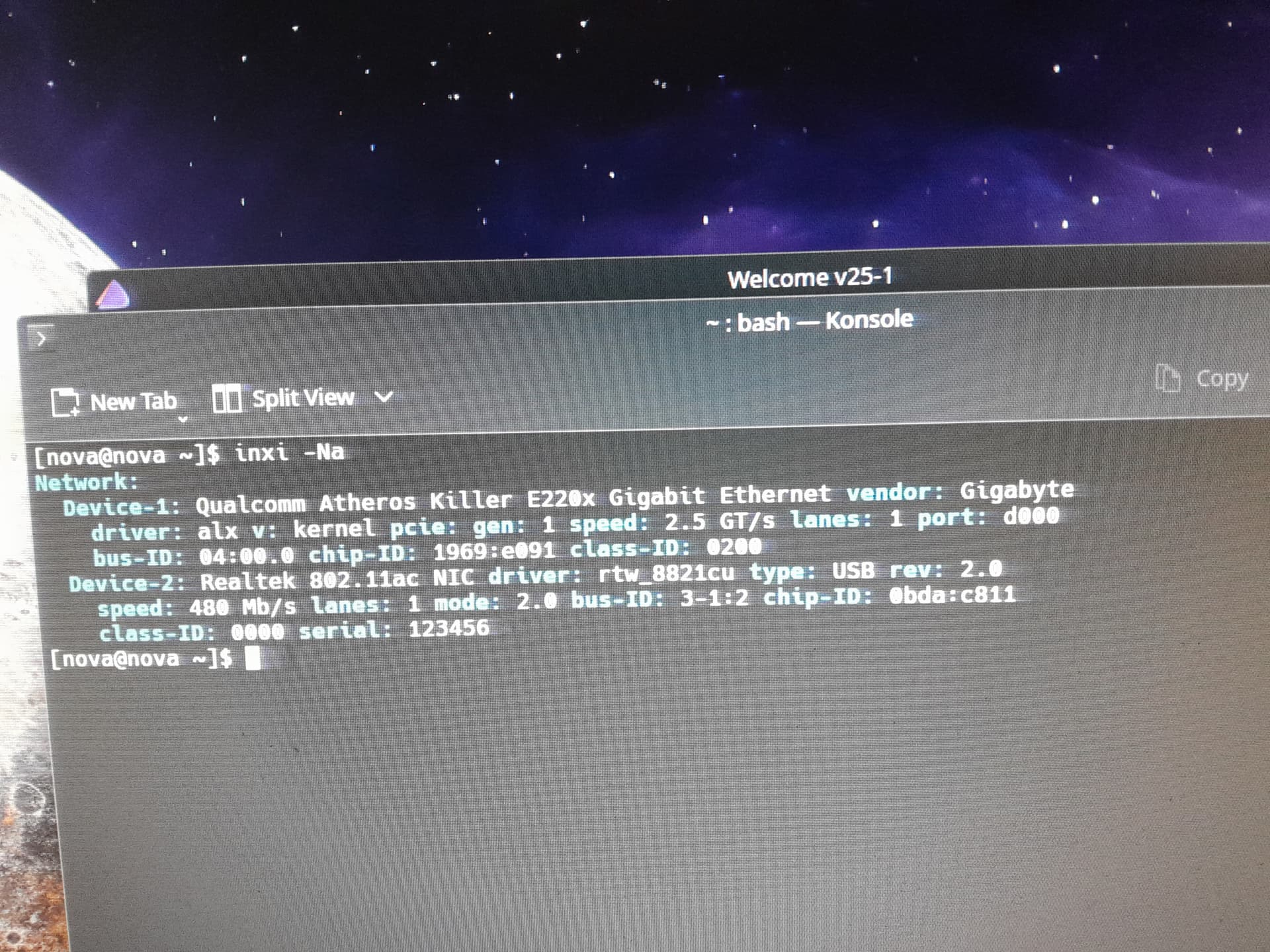

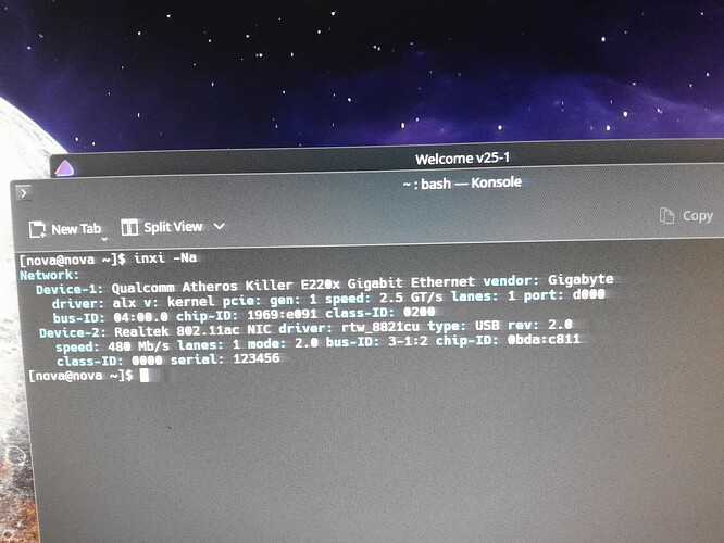

Are you able to show the hardware? Are you using ethernet or WiFi?
inxi -Na
The powerline shouldn’t matter to your OS (it’s a black box). Your problem should be elsewhere (like NIC support) or DHCP.
I was using WiFi through a dongle but it’s so slow I had to do an offline install.
Output is above
It looks like the hardware is showing working.
