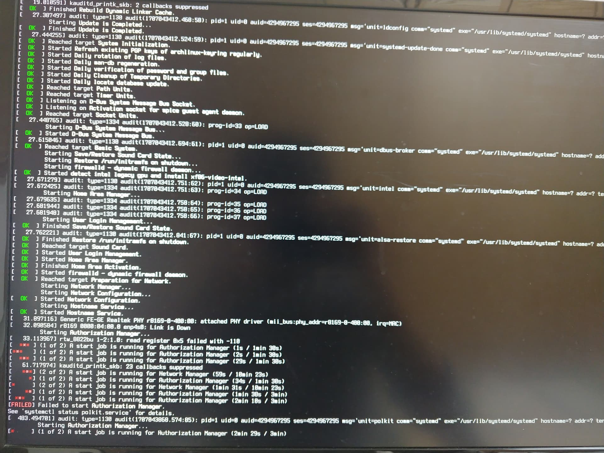

Hello, newbie here. I am using USB wifi adapter and chipset is rtl8812bu.
When I tried to install EOS, it stucked on NetworkManager when booting.
So I unplugged adapter and it worked again.
After installing EOS in offline mode, I plugged adapter again, connect to wifi and OS freezed. I opened tty and typed simple commands but nothing responed, just blinking curor.
