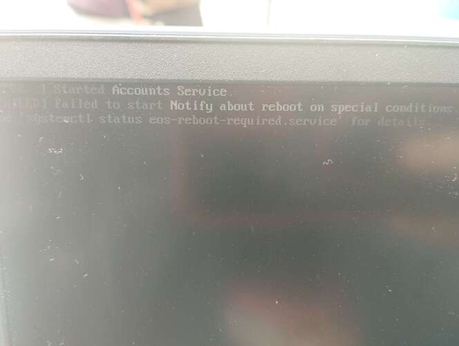

So as the title says, I tried to install Optimus Manager from the AUR for my laptop, since I wanted to handle my drivers and battery life. After installing it it told me to reboot the system and I did so, but the following error came up. If there’s a way to solve it and recover my stuff I’d be greatly, greatly appreciated
When did you last update your system? Issues with notifying about needed reboots was another discussion this week here, but I know too little about that program

And about this, only like two days ago actually: the error (from what I can piece together) mainly came after downloading the Optimus Manager in the AUR, so the chroot may be the safest (if not only) solution for me rn
