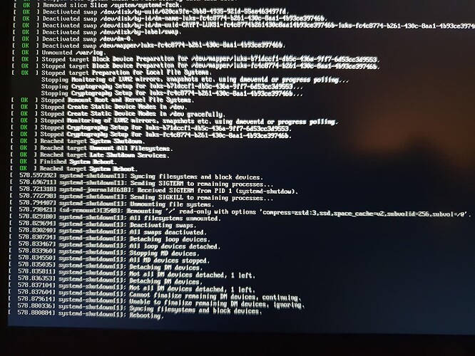

I am on a Thinkpad X280 (pure Intel Kaby Lake R stack), running EndeavorOS KDE with linux-lts kernel and doing full system updates about 2-3 times a week.
After one of the last system updates (I could not tell which exactly, around 29th/30th-ish) the system would not properly shutdown (and neither reboot) any more. It gets stuck with the following messages (“Not all DM devices detached…”) and I have to hard-shutdown.
