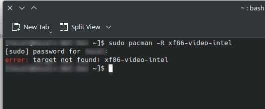

I get an error trying to remove it with that command
Check if it’s even installed.
pacman -Qi xf86-video-intel
Not installed.
Says "error: package 'xf86-video-intel' was not found"
