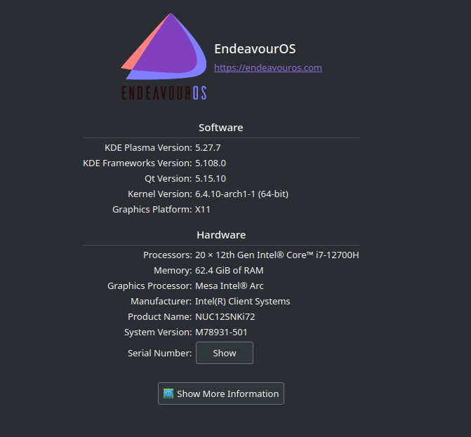

Fair enough. I attached my system info below. As far as logs or any other info goes, please direct me on how to provide that, as this will be my first time.
Note: I use systemd-boot (default option when installing)

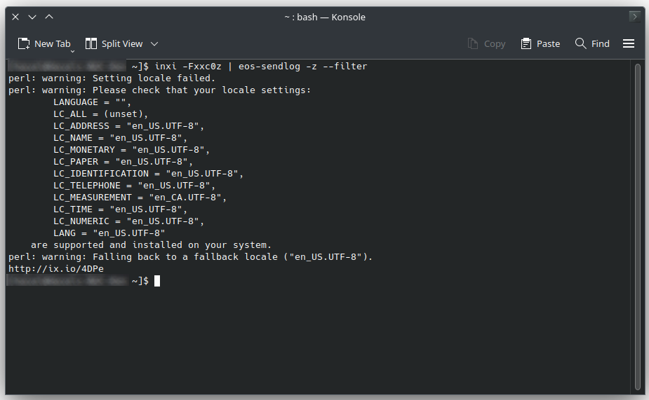

I tried the first command it’s giving me for the hardware log in konsole, and I am unsure what the next step is? Where’s the log? :point_down:t3:
You just post the url.
Edit: The url has the uploaded log from the command.
This looks like an Intel NUC system with an Arc 770. Looks like it also has onboard graphics? Looks like it’s running on the Intel driver. xf86-video-intel As far as i know the Arc Gpu should run on a kernel module. Maybe try uninstalling the Intel driver and see how it works.
Correct. Intel NUC with both ARC GPU and an onboard. As far as I can tell, the ARC GPU driver is installed and working as intended. I say that because it runs steam games as it should. Whatever driver is installed did so on its own when I installed EnOS.
Note: I switched from a different NUC PC to this one about a month ago. The previous one was an Nvidia GPU that had zero issues. This INTEL GPU one has this freezing issue and also very often does not suspend the screen at the set time. Not sure if it’s related to the same problem, but I thought I’d mention it.
