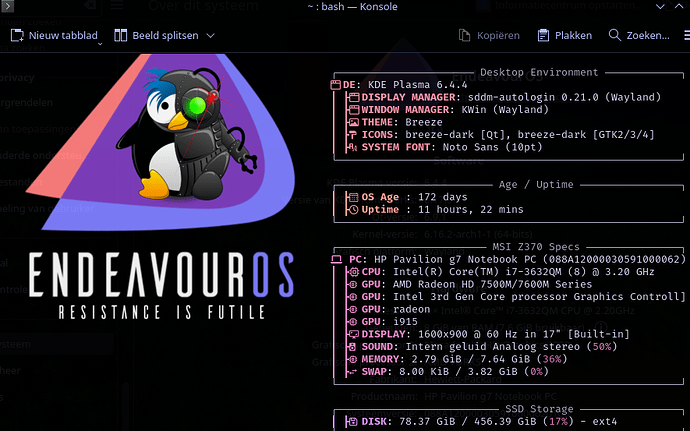

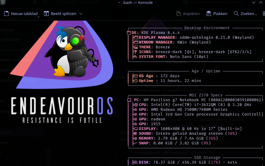

Not a single issue on my HP Pavilion notebook, i am using this notebook for the last 2 weeks.
Yes i know i have to tweak my fastfetch, this one has been taken over from someone else and got lazy to alter it
