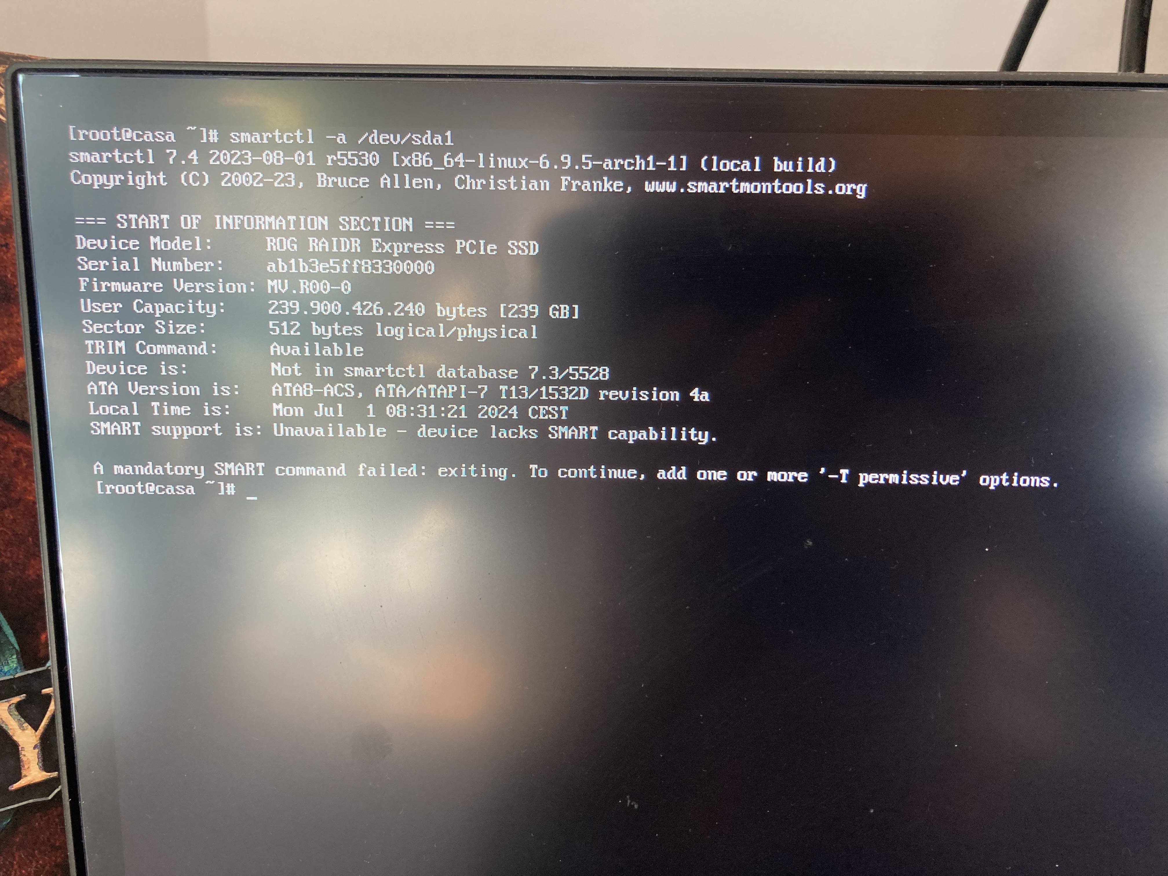

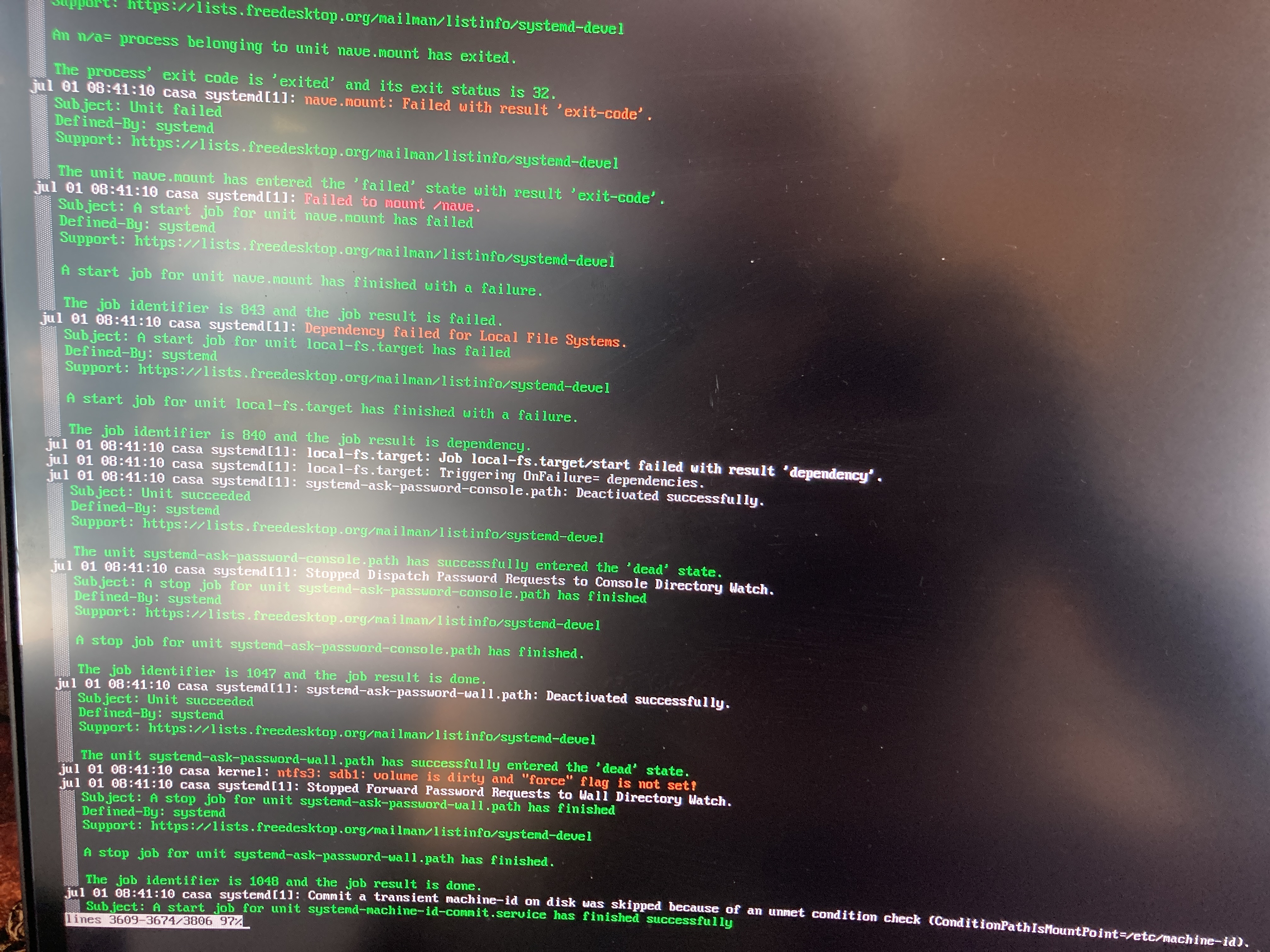

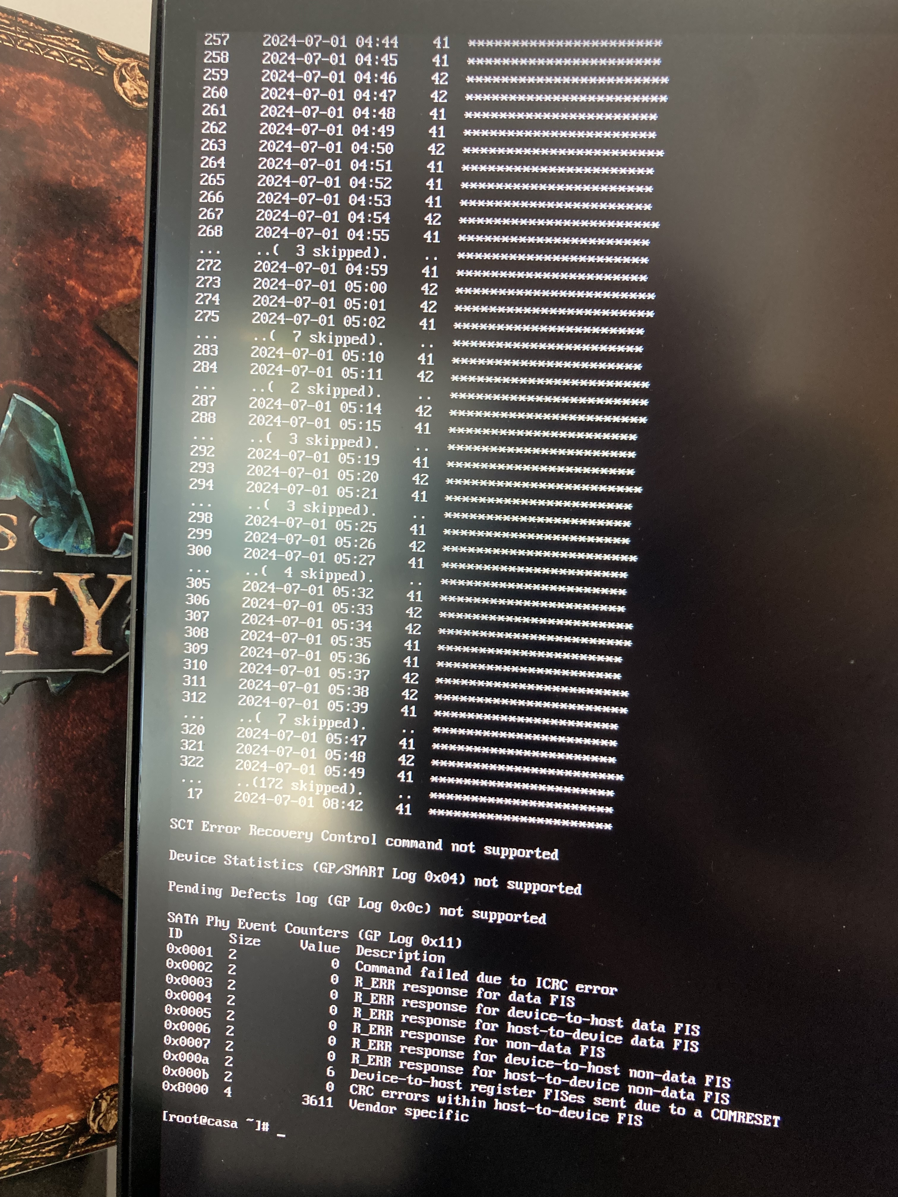

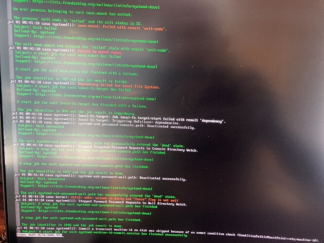

After seeing an issue with /dev/sdb1 on journalctl I run smartctl -x on it with the following result
The issue detected on sdb1
Is that about a ntfs partition that you mount at boot via an entry in fstab?
There seems to be some data inconsistency/corruption in it preventing it from being mounted.
Try commenting it out in your /etc/fstab and see if your system will boot.

If you are dualbooting with windows and ntfs being a Windows filesystem, my suggestion would be to run a filesystem check from Windows.
If not,
ntfs3 will not mount a partition where the volume is marked dirty without the force option. dmesg explicitly helps recognizing the situation, saying:
sdb1: volume is dirty and “force” flag is not set!
You can try passing the --clear-dirty argument to ntfsfix(8) to clean it. [1]
https://wiki.archlinux.org/title/NTFS#Unable_to_mount_with_ntfs3_with_partition_marked_dirty
So that would be:
sudo ntfsfix --clear-dirty /dev/sdb1
See also: https://man.archlinux.org/man/ntfsfix.8
