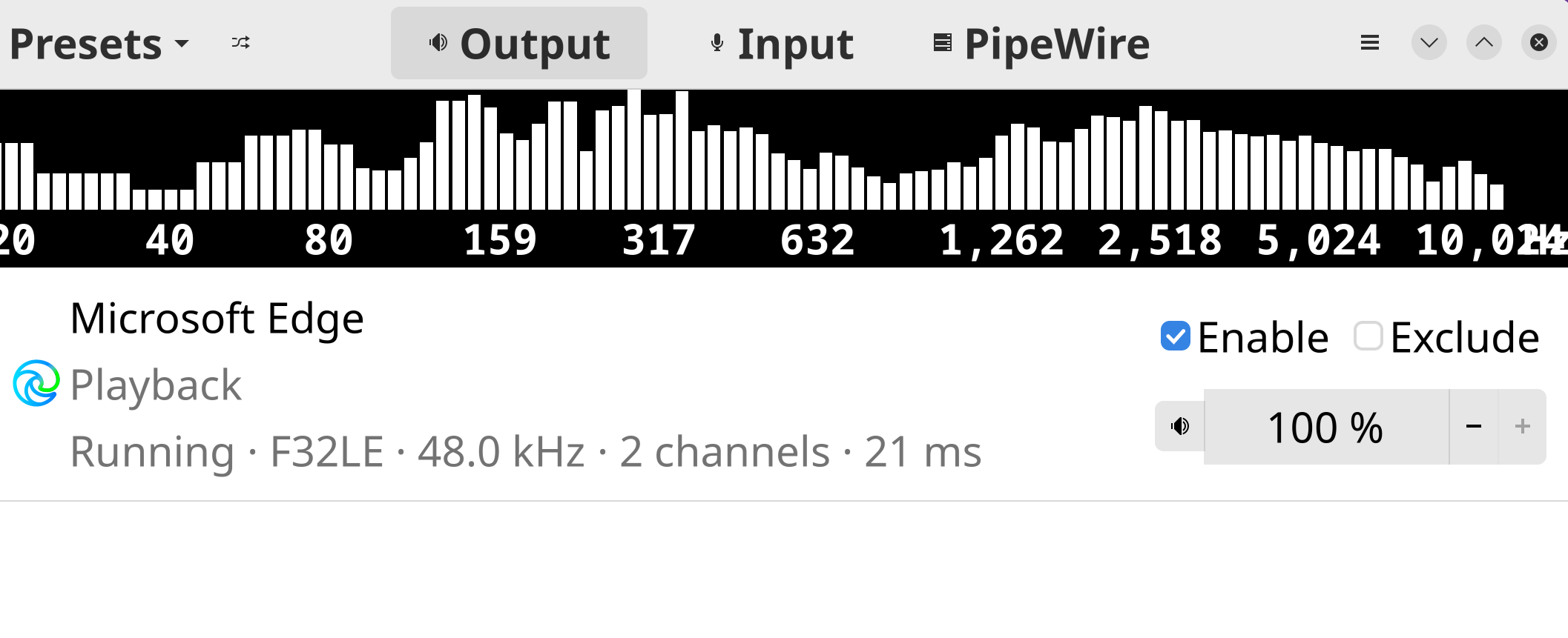

I have been trying to switch between Nvidia sound and motherboard embedded sound. I’m using pipewire and easyeffects. Both working fine with nvidia sound. But would be good to know how to switch them. I have installed the plasma widget “Audio Device Switcher”, after trying with pavucontrol. No luck so far but it does show activity in the volume icon in the system tray when I switch to 2nd card. Here’s a little info:

[audio|511x500](upload://sqYy2Izslt81Su20I99daWZVB56.png)
With nvidia : sound working fine.
