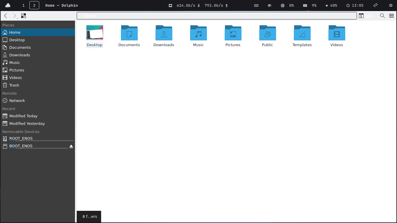

Using qt6ct I have successfully got konsole and kate working with Sway with a dark theme. Dolphin is the sticky wicket, this is the closest I have come so far.
Has anyone gotten Dolphin with a dark mode working on Sway?

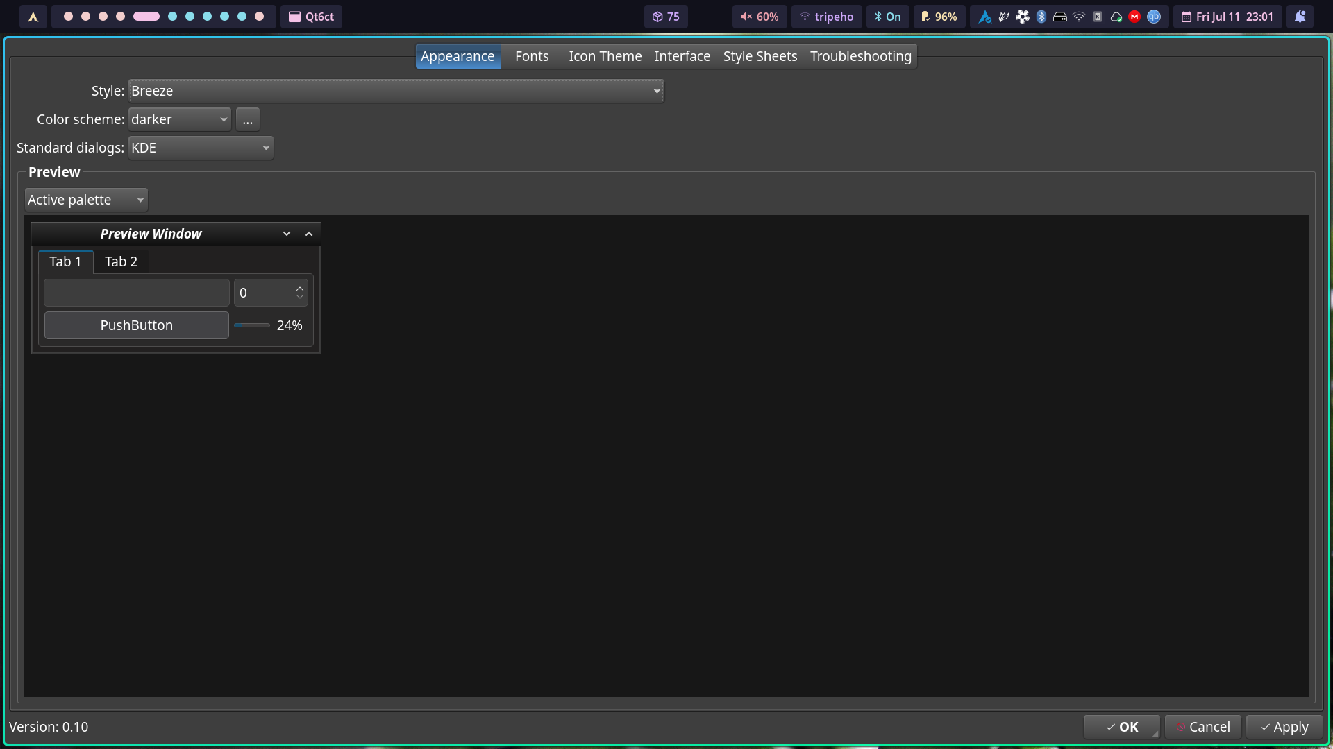

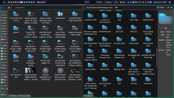

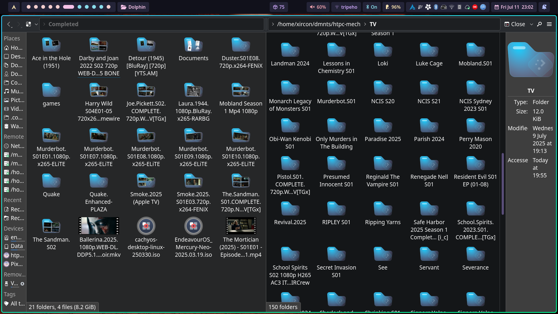

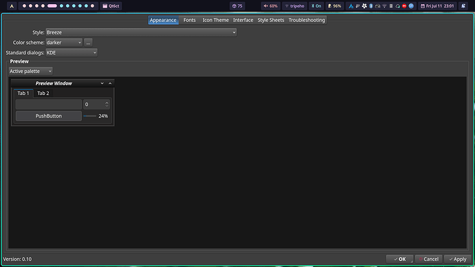

Hyprland, qt6ct - this works for me:
@xircon

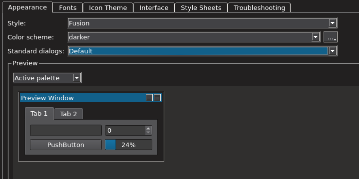

With Sway, this is what I get which differs from your Hyprland settings:
Under Appearance Style: the only choices are Fusion or Windows Breeze does not appear as in Hyperland.
Under Appearance Standard dialogs: only
Default
GTK3
XDG desktop portal
appear. No KDE option appears. This is probably part of the problem but I haven’t figured out how to change it.

I started from a plasma base, may explain why I have the option.
