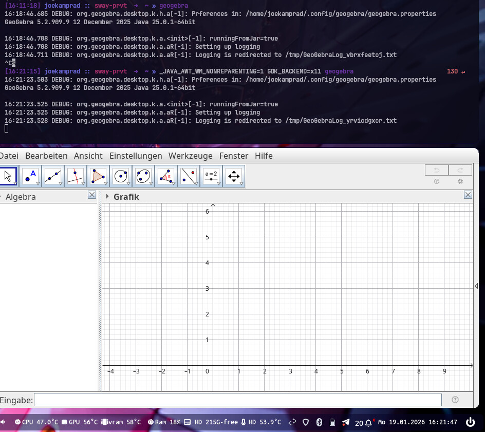

[Sway] Geogebra white screen
Basically title, I want to switch from i3 to Sway, but Geogebra (geogebra from Arch repos) launches to a white screen. It’s fine on i3, or Xfce, or Plasma…
What should I do to fix it?

Seems simply not running on xwayland by default you should try starting it from a terminal like so:
_JAVA_AWT_WM_NONREPARENTING=1 GDK_BACKEND=x11 geogebra
This forcing it to run X11 // xwayland
i see _JAVA_AWT_WM_NONREPARENTING=1 geogebra
works already the same.
With this you can add a environment variable or a custom starter and it would work from menu.

Yay, it works, but I don’t know how to make fuzzel launch Geogebra with this env variable by default. How to make it do it?
