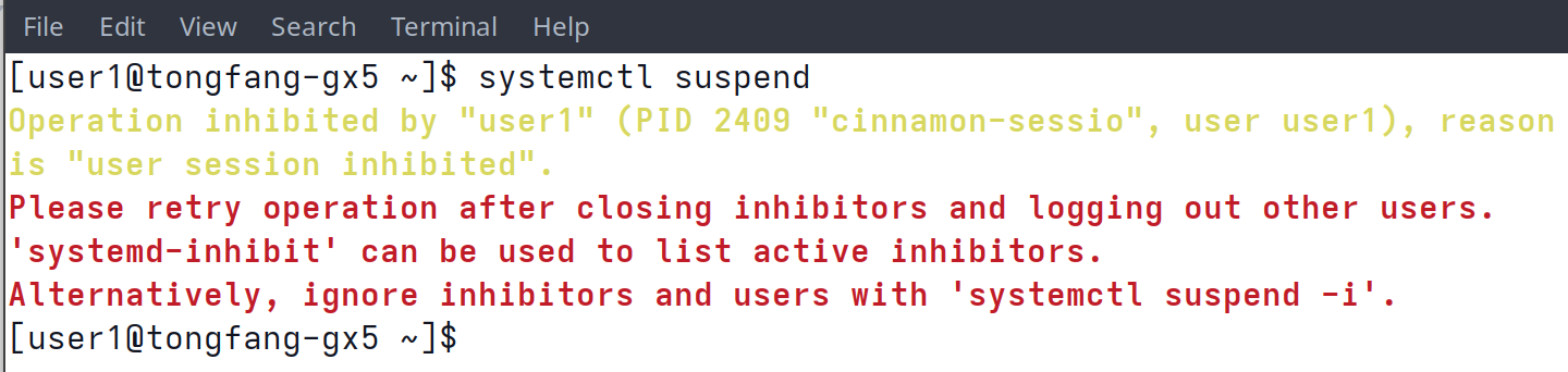

Yesterday I wanted to suspend my laptop but it did not work, nothing happened. So I tried systemctl suspend, and this is the output from the terminal:
[user1@tongfang-gx5 ~]$ systemctl suspend
Operation inhibited by "user1" (PID 2409 "cinnamon-sessio", user user1), reason is "user session inhibited".
Please retry operation after closing inhibitors and logging out other users.
'systemd-inhibit' can be used to list active inhibitors.
Alternatively, ignore inhibitors and users with 'systemctl suspend -i'.
When I did systemctl suspend -i it worked, though I had to give my password.
Now, the output says something about Cinnamon, but I don’t understand what it means, and more importantly, what caused it. How can I avoid it happening?

What did systemd-inhibit return? Btw, please don’t post pictures of text.
I did that to show there were 2 colors; I was not sure if that was relevant, so just in case …
Please explain why it is bad I did?
In any sase, I have posted the text itself so as not omit anything.
I did not check systemd-inhibit as I was focused on “cinnamon-sessio”. Oddly enough, the suspend issue has gone, although I don’t know how. It is not the 1st time it happens, so if it recurs I’ll definitely get the output from systemctl-inhibit.

#HandleLidSwitchDocked=ignore
#HandleSecureAttentionKey=secure-attention-key
#PowerKeyIgnoreInhibited=no
#SuspendKeyIgnoreInhibited=no
#HibernateKeyIgnoreInhibited=no
#LidSwitchIgnoreInhibited=yes
#RebootKeyIgnoreInhibited=no
#HoldoffTimeoutSec=30s
#IdleAction=ignore
#IdleActionSec=30min
#RuntimeDirectorySize=10%
#RuntimeDirectoryInodesMax=
#RemoveIPC=yes
#InhibitorsMax=8192
#SessionsMax=8192
#StopIdleSessionSec=infinity
#DesignatedMaintenanceTime=
Since I have and use a Suspend key on my keyboard, I uncommented SuspendKeyIgnoreInhibited=no and replaced no with yes.
You can choose a more appropriate key from the list.
I only did that today so I am not sure if it will work. I will add [SOLVED] to the title in case I foget to do so if this has a long term positive effect. If the problem recurs I will delete [SOLVED].
