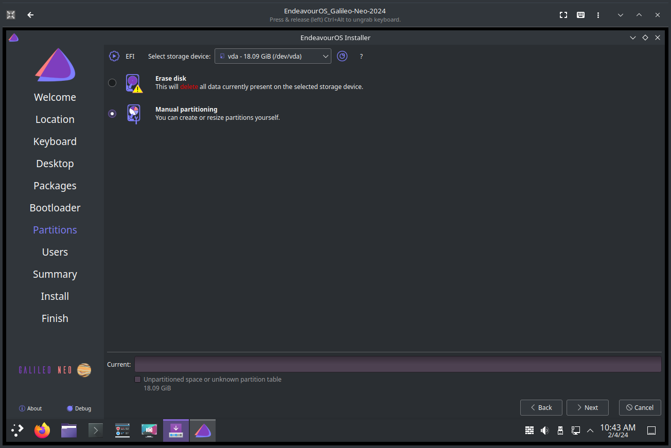

Are you sure about this? When I select
and go the next step:
everything is empty and nothing is prefilled.
That’s the only thing that always bothered me with the EndeavourOS installer.
I would love for something to be prefilled when selecting “Manual partitioning”.
I just tested it again. “Manual partitioning” only shows what already exists on the selected drive.
