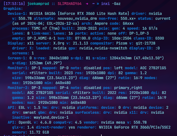

Thanks that explains it! I have one more question. I have installed the open drivers for Nvidia but how do I make sure they’re selected? When I do inxi -Ga it still shows Nvidia550 as the driver.
2024-05-05_17-56
It will not show that you are using nvidia-open on inxi… i use nvidia-open too, and it does not show up different there…
but packages are conflicting.
So only one or the othr can be used.
If you have open installed and you run initramfs rebuild you will use it.
