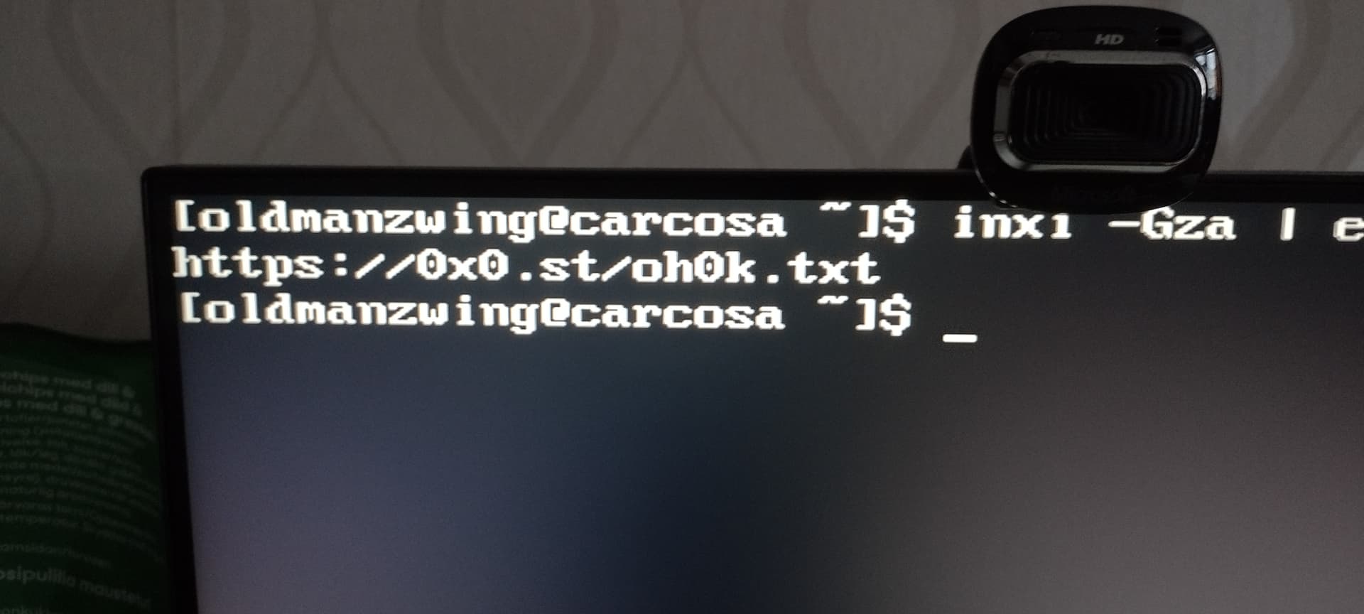

Please show the URL returned by command
inxi -Gza | eos-sendlog
manuel

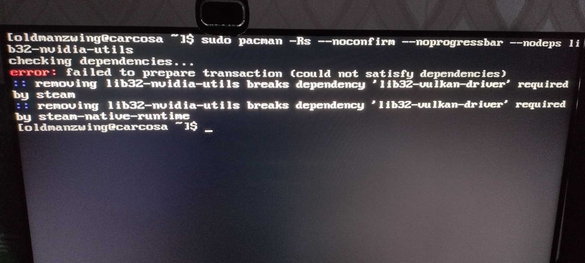

My Nvidia-inst -t gives me.
Have no idea how use grub commands.
Can’t remove suggested package gets this prompt

Did a -Syu update for the system
When using Nvidia-inst I still get the steam Vulcan conflict as shown in pictures above.
