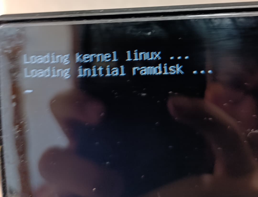

Hi folks,
I know that this thread may have been posted a dozen times already, but I’m looking on how to fix it with no avail.
Here is what I have tried so far:
Updated my BIOS to the latest version
Chroot and run pacman -Syu
Run mkinitcpio -P
under chroot
Run pacstrap from the live USB and resintall a few packages
My system:
AMD Ryzen 1400
Mobo Asus B350m
Nvidia 1050ti
Please guide on what I should try next. Thank you for your time.

Thank you for the fast response,
Seems that I don’t have installed resintall-kernel
nor dracut-rebuild
. Forgot to add that I installed eOS around October 2022. Seems that I’m using mkinitcpio because I have a config file on /etc
, and I dont have /etc/dracut.conf.d
You think installing dracut may help?

Solved!
Here is what I did:
Downgraded to the previous kernel version I had on cache
Grub reinstall and make config as your comment says
Seems that the latest kernel may have an issue with my system. I will update and carefully look at the logs next time!
