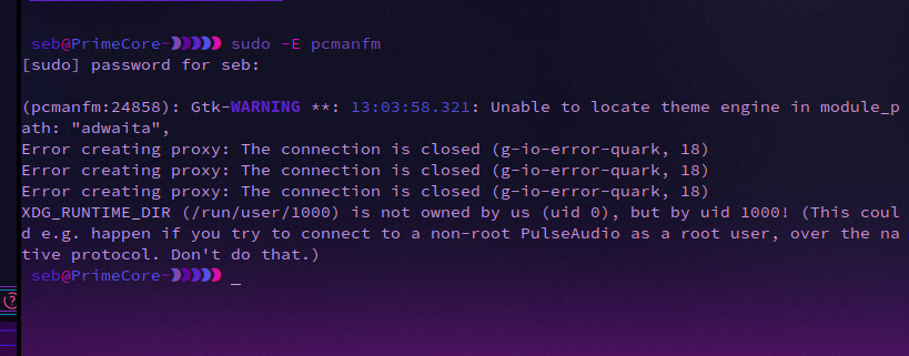

I tried to do sudo -E pcmanfm and it still comes up with a light theme, This is quite confusing. I really wish I knew where to read up to understand the basics of all of how themes work when it comes to root and running applications as sudo.

Here is what happened when I ran
Sudo -E Pcmanfm in a terminal, Maybe this will help shed some light on what is going on and how I could fix it
