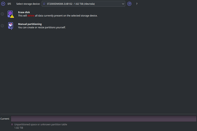

Hello hello again. Thanks for the responses yesterday. I’m trying to only boot EndeavourOS (KDE plasma), making the switch from Ubuntu. I have a 2tb HDD and 500gb SSD, I want to install EOS (systemd boot) onto my SSD which currently has Ubuntu installed.

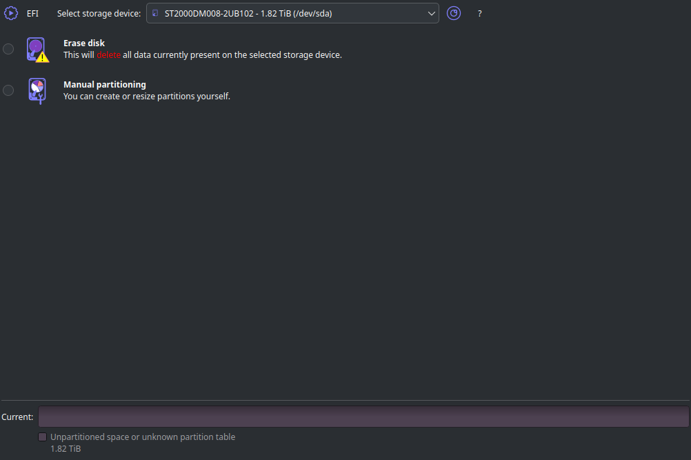

When I try to erase disk I get this error redacted

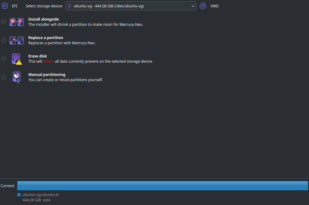

When I try to replace partition the next button isn’t highlighted and won’t let me press it.

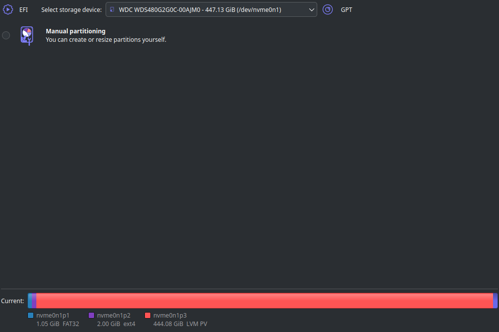

It seems like my only option is to manually partition my ssd but I’m not sure if I do the manual partition on the one showing as ubuntu or nvme0n1. I’m assuming it would be nvme0n1 because it’s bigger.

On this screen check replace a partition next you have to click on the blue bar on the bottom and a option to create a efi partition should pop up. If for some reason this doesn’t work you can create a partition using Gparted on the live installer.
Also make sure you did not mount the disk before running the installer. When it’s mounted in the live environment you get less options as well.
Issue could be caused by the LVM ?
In case calamares (installer) tries to reuse the LVM somehow was it mounted on the livesession before starting installer?

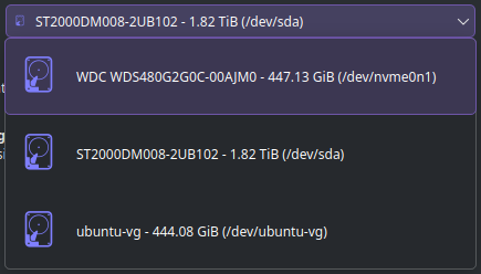

the /dev/ubuntu-vg is housing on /dev/nvme0n1p3 ?
2025-05-13_18-48
And only shown as a drive as of the LVM ?
In reality you have 2 Harddrives installed i think?
The way to go would be to remove the partions manually before installing so that the LVM is not getting reused.. only in case you want to use WDC /dev/nvme0n1 drive for replacing it with EndeavourOS.
Open partitionmananger and create new partition table (gpt) reboot and try again. Make sure System boots in EFI mode too (terminal a like boot menu and use boot entry for USB starting with UEFI) or check on the livesession ina terminal run: efibootmgr will shhow boot entries if EFI if not shows an error.
