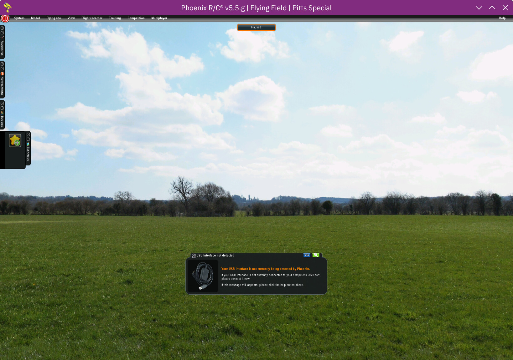

I get until this window where I can pan around with the mouse:
That is it! (There is also a shim on that site you can run that simulates the dongle - I believe it only looks for a specific USB ID - and can use a regular controller - the radio itself acts like a joystick as far as the OS thinks)
