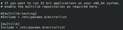

Hello! So,
I checked pacman.conf, multilib is enabled. Should I enable multilib-testing?
I’m unsure what checking the path for Steam entails, but heres the folder for it.
