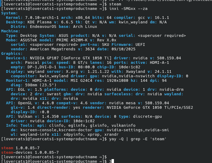

Please share the output of:
inxi -SMGxx --za
yay -Q | grep -E 'steam'

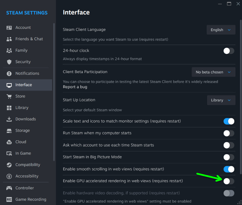

Try disabling GPU acceleration in Steam:
I can’t open Steam settings because it won’t open.

@LoverCats was able to confirm Steam was installed, although the details are locked up in the image above. In hindsight I gave a more complicated command than necessary because I was originally going to check for a couple things.
@LoverCats’s output was:
$ yay -Q | grep -E 'steam'
steam 1.0.0.85-7
