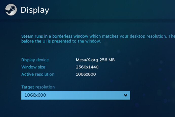

Hello everyone. I’ve been enjoying gaming on Linux for the past few months and I just found an issue that prevents me from streaming locally to my TV: Whenever I launch Big Picture, Steam does not use the GPU and the streaming runs at 15-20fps max… I tried streaming using a Windows PC and it went fine, so I don’t know what to do.

if you look at the screenshot in the opening post it shows a generic ‘Mesa/X.org 256 MB’ instead of the RTX 2080 in the system…
when using steam link over here on my pc, it correctly shows my Radeon RX 5600XT…
My guess is this is what was meant when OP said the GPU isn’t used
This was kind of my question from before - what is it using if not the NVIDIA GPU, given the 2080 is the only output available? If it was using llvmpipe or something for software rendering it might make sense, but I don’t know why that would happen, unless it’s GNOME getting in the way, maybe it needs to undirect the window to disable the compositor? But even then, windowed applications will work just fine (e.g. games running in a window), so why would Big Picture be any different?
