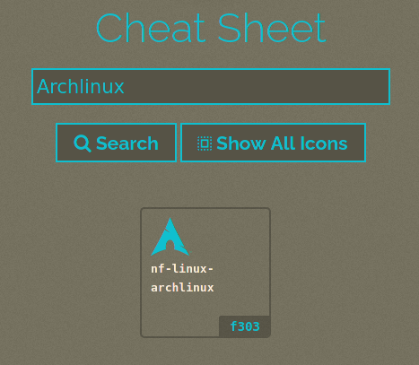

Yeah, removing nerd-fonts and leaving only font-awseome installed was the workaround I opted for. I lost the “Arch” glyph though…
arch glyph

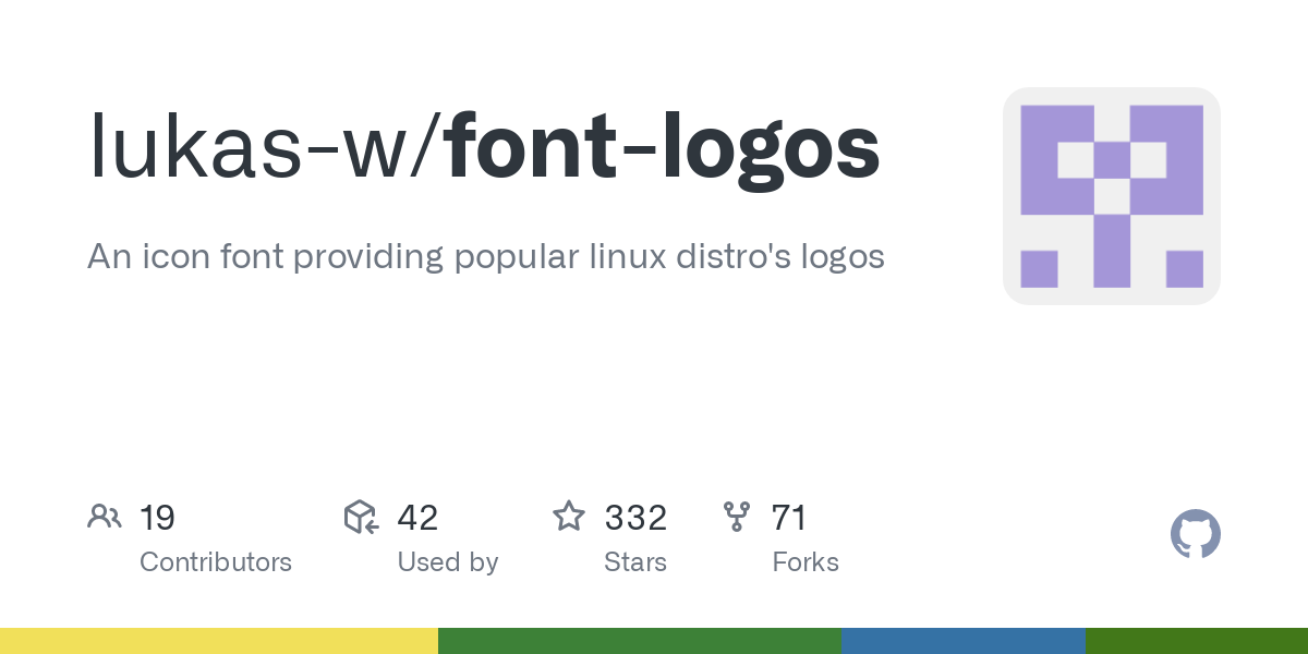

Try here?
AUR package seems actively maintained.
https://aur.archlinux.org/packages/ttf-font-logos/
