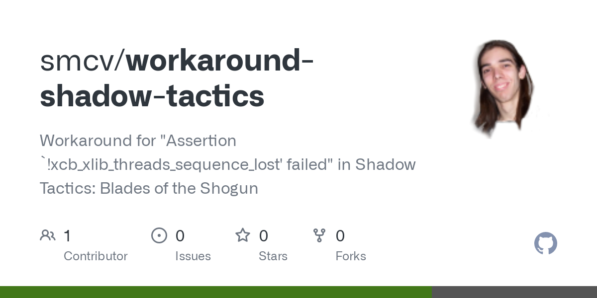

check this out. It looks like the same issue?
@KDen Yes, this seems to be exactly the issue.
It’s the first time for me to compile something. I have just looked online how to do that. Is this the right way: https://www.makeuseof.com/compile-install-software-from-source-linux?
Edit: There is no “configure” script, so I can not compile it as described in my link above.
The README.md says: “Compile 32/preload-xinitthreads.so from this repository”. But I do not find a “preload-xinitthreads.so” in the repository. How to compile it then?
all you have to do is download the preload-xinitthreads.c and the Makefile then just type make in the same directory you downloaded them into. It will create a folder callded “32” which will contain the compiled library file
Edit** or just do it all at once from the command line :stuck_out_tongue: curl -o preload-xinitthreads.c https://raw.githubusercontent.com/smcv/workaround-shadow-tactics/master/preload-xi nitthreads.c && curl -o Makefile https://raw.githubusercontent.com/smcv/workaround-shadow-tactics/master/Makefile && make
