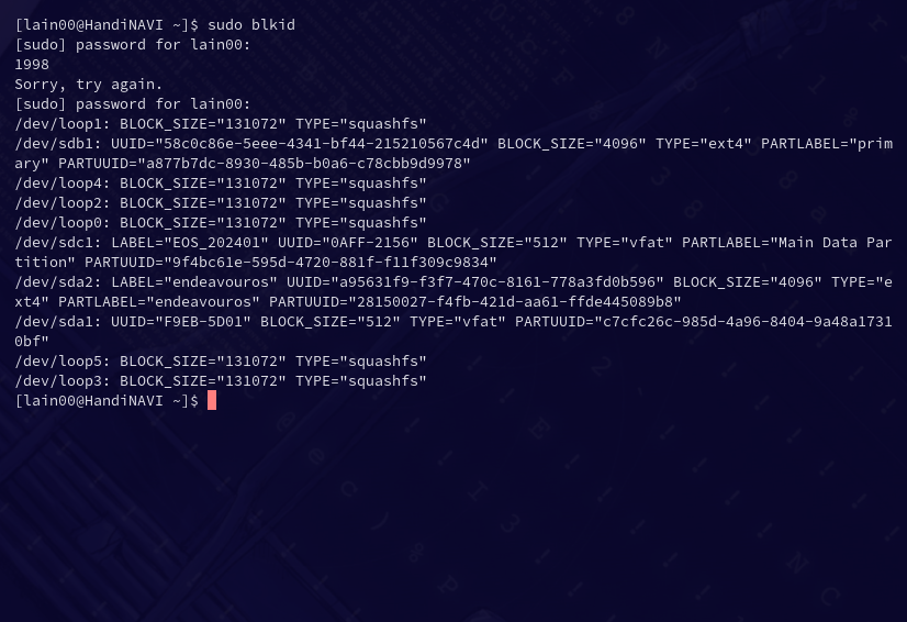

Show the output of sudo blkid
Hi, thanks for the reply. Here is the screenshot,
Is /dev/sdb the SSD that you can’t seem to mount?
Yes, that should be my second ssd. I do see that I might’ve glanced over it on the second line. It should be the ssd that doesn’t contain endeavour os.

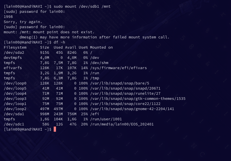

Try:

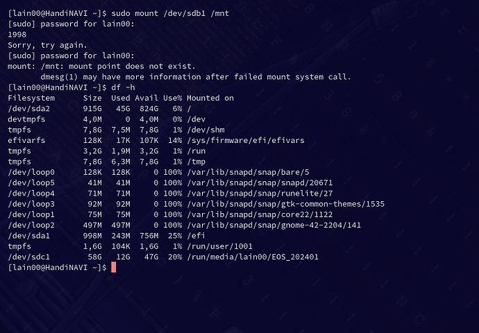

sudo mount /dev/sdb1 /mnt and show the output of df -h after
Says mount point doesn’t exist.
make a mount point in your home folder so: mkdir ~/ssd and mount it there: sudo mount /dev/sdb1 /home/yourusername/ssd

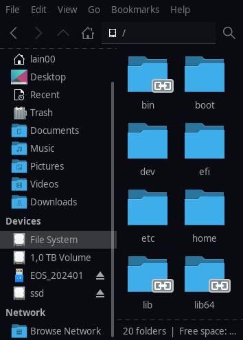

I just did that and the ssd showed up in devices in thunar!
Screenshot_2024-02-22_20-40-05
Is the device an external ssd ?
No internal. When it was working just fine I didn’t had the unmount button and the ‘‘ssd’’ label show up. When I click it just puts me to ‘‘1,0 TB Volume’’
