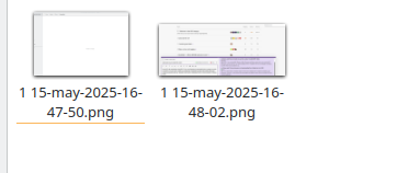

Took some screenshots to try it out again for this post, currently it looks like this:
As you can see there is no “Window name” and both screenshots (including this one which is for the example, meaning the 3rd screenshot) start with “1” instead of being 1, 2, 3, etc.

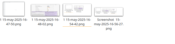

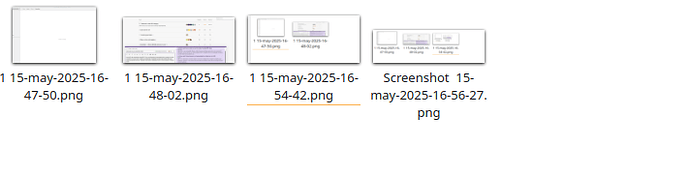

After changing the naming scheme to something more “default”, it looks like this:

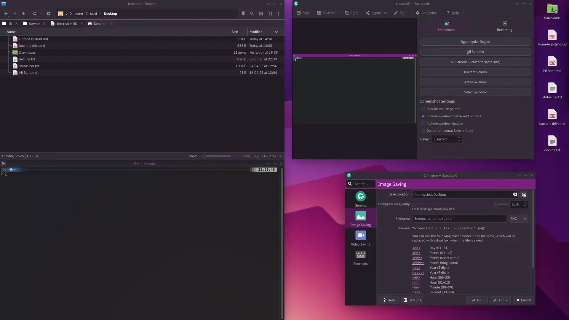

It should refer to the title in the titlebar. Here’s a quick example of what I see on my end:
transparent
But there still could be a bug worth opening at kde considering your particular setup, if it doesn’t work.
