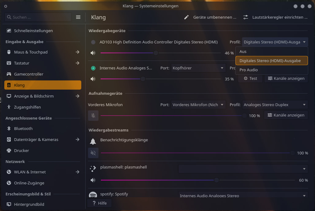

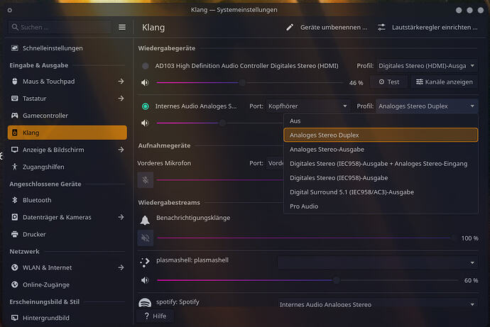

I have a lot of options to choose from when setting up my sound (even more on my laptop as there are more speakers, my monitor actually doesn’t have sound built in):
Apart from that, i wonder if you have it installed, is it updated? Or if you are still sitting on an ISO, are you using a current one?
