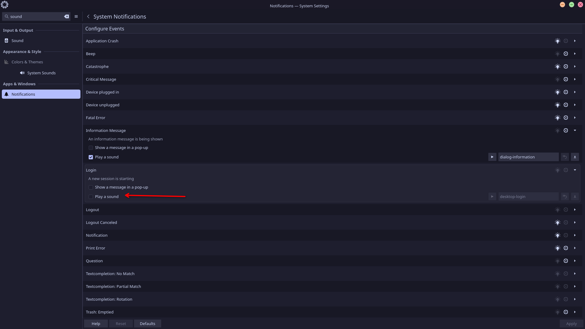

Haven’t tested but perhaps here? (I’m pretty sure it isn’t set by default)

I think I found it!
Go to Settings → Notifications → System Notifications and select a sound for login. Click apply.
