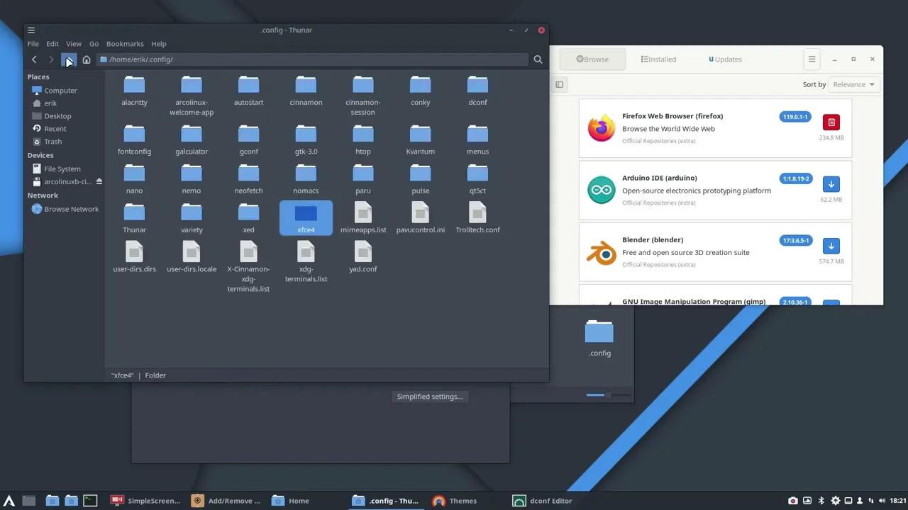

Hi there, I was wondering if someone could help me with an annoying thing I noticed on Openbox. I used Lxappearance to set a GTK theme but I noticed some apps (gnome system monitor, dino, and pamac) still have the Adwaita theme. This for sure is not set anywhere. I’m wondering if this is because it’s a GTK-4 thing. At the very least I’d like to get it to default to Dark mode but ideally I want it to follow my actual GTK/Openbox theme. Any ideas on how to do this?

If apps are designed to use libadwaita… they will not follow gtk theme settings the same way as you are used to for gtk 2 and 3 …
There are ways to set their theme too, but not with lxapperance.
And for this, dconf-editor is your friend.

Edit: Hmm, unfortunately I got over excited and I do see that Adwaita isn’t listed on anything but a deprecated dconf value, for everything else my GTK theme is listed and use default isn’t checked.
However, I do have both cinnamon and openbox installed. I wonder if some wires got crossed there. I also don’t know much about GTK 2/3 etc and maybe my chosen theme doesn’t fall back properly.
Second edit: Poked around back in cinnamon and tried to change the theme again, no dice. Did some digging and found this which did the trick: https://github.com/trinitronx/libadwaita-theme-changer/tree/add-os-theme-packages-support
Also some of the themes I had didn’t have gtk-4 support so maybe that’s where I got wrong.
