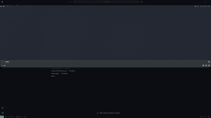

I’m using EndeavourOS with KDE Plasma 6 on Wayland, and I’m experiencing an issue with Yakuake. I have a top panel in my setup, and it seems to prevent Yakuake from opening at the very top of the screen.
Instead, Yakuake always appears below the panel’s position, even when the top panel is hidden (e.g., while another application is fullscreen). Despite trying various approaches, including tweaking window rules, I haven’t been able to fix the problem.

The panel is set to auto-hide, but the Yakuake window still appears beneath the panel’s original position. Please refer to the uploaded images. Even when other applications are open and the panel is hidden, the Yakuake window remains positioned as if the panel were still visible at the top.

As you can see from my screenshot. The panel is behind yakuake. Did you have a kwin crash recently. I know that causes yakuake to not work right until you fully close out of it and launch it again?
I haven’t encountered any crash reports for the window manager recently. However, since I tweaked the window manager and window rules recently (in an attempt to resolve this issue), it seems something in KWin may have been broken. After restarting the system, the auto-hide feature now works as expected (one problem solved).
However, the main issue remains: making Yakuake open at the top of the screen when switching the panel setting from auto-hide to “dodge windows.” As you mentioned, this doesn’t seem to be possible at the moment. For now, using auto-hide is the only viable option, and I’m hoping for future updates in KDE to introduce such a feature.
