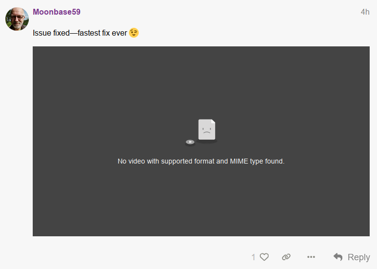

On a couple topics, @Moonbase59 posted a video. Here and here. This is what I see…
So, it’s either a codec issue or something specific to Firefox/Librewolf because the videos on both posts play fine in Vivaldi.
Not a firefox issue.. I can see that video just fine in firefox!
Odd. In both Firefox and Librewolf I get that “No video with supported format and MIME type found”
I did a search for that and found the typical suggestions of deleting cache and cookies. Done, still the same.

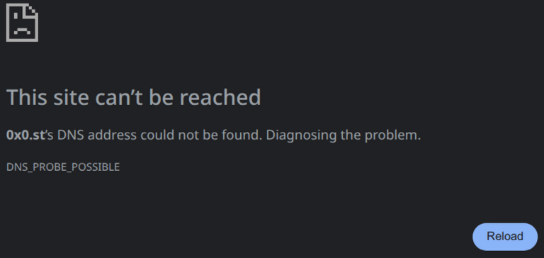

Didn’t work for me either @UncleSpellbinder, but I suspect it may not be codec related, as trying to open the direct video link, produced a DNS error. I suspect perhaps browser or VPN based filtering.
https://0x0.st/8l8k.44.mp4
Well, I had no VPN active. So I suspect it may be an ISP issue stopping that domain. Because I just activated Mullvad and it shows just fine…
EDIT: Ahhh yes. The dreaded 0x0.st domain. I’ve already had an issue with that.
Yeah, sorry, I used @cscspastelo to quickly upload it. It might also vanish in a while, these services delete stuff after some time…
Not the first report of 0x0 being unreachable.
Some ISPs, networks, and even some lists out there (such as those sourced by hblock) block it due to being seen as a source of malicious scripts. Seemingly it just depends on the service and how popular the paste host is.

It is blocked if you’re using hblock :
grep 0x0.st /etc/unbound/blocklist.conf
local-zone: "0x0.st" always_nxdomain
edit: just noticed cscs mentioned it.
I guess I could mention that hblock has an allowlist though, ex;
~/.config/hblock/allow.list
# A domain on each line creates exceptions on next run of hblock
0x0.st
envs.sh
I could use it, but in my case, hblock is only meant to download the list, then it’s converted to be used by unbound .
