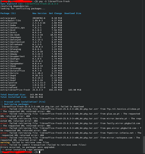

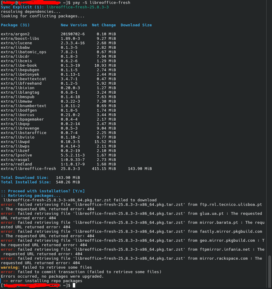

I tried downloading the libreoffice-fresh installation from the Archwiki and got this result:
My noob analysis tells me the prtuguese servers migtht be down given the error 404?
I am not sure of what to do. If I can manage something I’ll update.
Thanks for the help!
Update your mirrors from the welcome app.
It worked! thank you!
First time experiencing the “Just update [something]” lecture.
For the next person in distress I did:
eos-rankmirrors --verbose
followed by:
yay -Syyu
Per this post.

Just as a tip, libreoffice-fresh is on the Arch mirrors, not on EndeavourOS mirrors.
So doing only eos-rankmirrors (that ranks only EndeavourOS mirrors) did not help.
The general update (yay -Syyu) probably helped in this case (assuming you didn’t do anything else to fix the problem).
The Arch mirrors can be ranked with e.g. reflector.
Got it.
I am still understanding the distinction between the more specific EOS commands and the more global Arch commands. I thought updating through eos-rankmirrorswould be the “most correct” solution. I still have a lot to learn!
