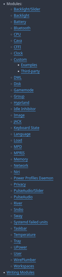

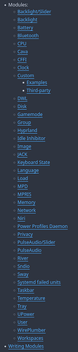

That’s right, the Idle Inhibitor is one of the default Waybar modules you can enable. If you are interested in learning more about different options you can configure in this (or any other) module, check out the Waybar wiki page: https://github.com/Alexays/Waybar/wiki/Module:-Idle-Inhibitor. It gives a chart with all the different options you can add to your Waybar config for customizing the module.
There are actually a ton of modules like this that you can add to your Waybar if you want to, just kind of built in to Waybar (you don’t have to install anything). Check out the list on the side of the wiki page and click on any of the modules you see if you want to check it out.
