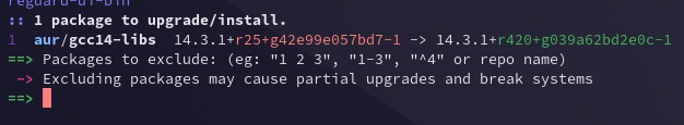

Hello Helpers,
Trying to do this upgrade of “gcc14-libs“ with yay command, resulted in “a lot“ happening in the terminal but ALL DAY long, until I had to interrupt to go to bed. Something must be wrong. What is this “gcc14”? How to find out why it cannot be upgraded within a day(!!)?
Thanks a lot

Gcc14 was moved from the Arch repositories to the AUR recently and compiles before installation now. You most likely don’t need gcc14 at all anymore, try to uninstall and check if a dependency complains.
