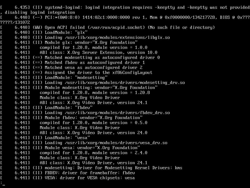

From Xorg.0.log:`

When I installed Xfce (offline) X-server failed to start with the logs shown above. I can login to a shell but there is no X Windows GUI.

Using your steps above (quick create) EOS starts fine on Hyper-V! I guess the difference was the way the VM was created. Creating a VM the old fashion way and then boot from ISO in virtual DVD did not work (X server fatal errors.)
