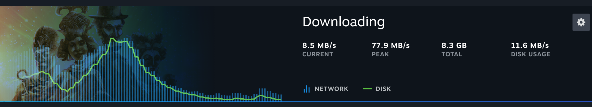

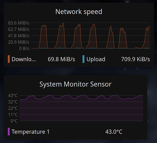

I’m on 1.2 Gbit connection with a WiFi 6 router, expecting download speeds above 70 MB/s. I can achieve that with Steam temporarily

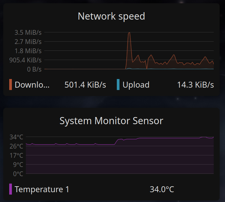

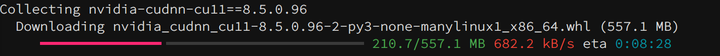

The speed fluctuates between 10 and 78 MB/s, but is overall acceptable. However, when I try to download via the terminal, like pip here for example, the speed will peak at approx 35 MB/s for a short time, and then drop to 1 MB/s or below and not raise back up.
This makes downloading via the terminal extremely slow. Every package starts off with 20-30 MB/s but then drops and remains at the slow speed until the download finishes. What you see above is that 200 MBs were downloaded very quickly and the reminder of the download speed remains low. The time at which the dl speed is high varies. The behavior persists through reboot, system upgrade, router reboot.
Edit: larger packages via pacman or the AUR show the same behavior.

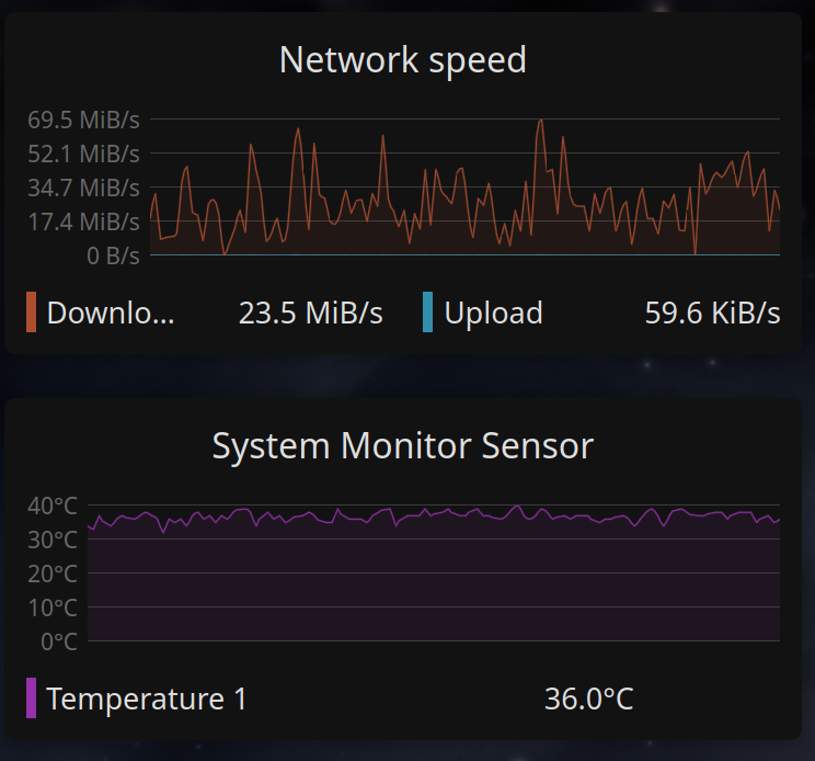

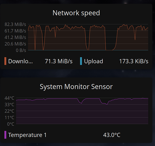

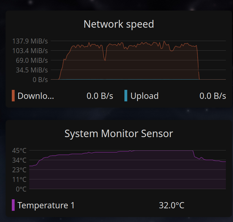

Diagnosing fluctuations

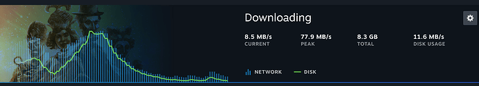

What I saw with steam was likely caused by thermal throttling of the WiFi chip, below you see KDE’s System Monitor output during the download I showed above.
Not great, but this seems like an acceptable behavior when the fans are not running full-out.

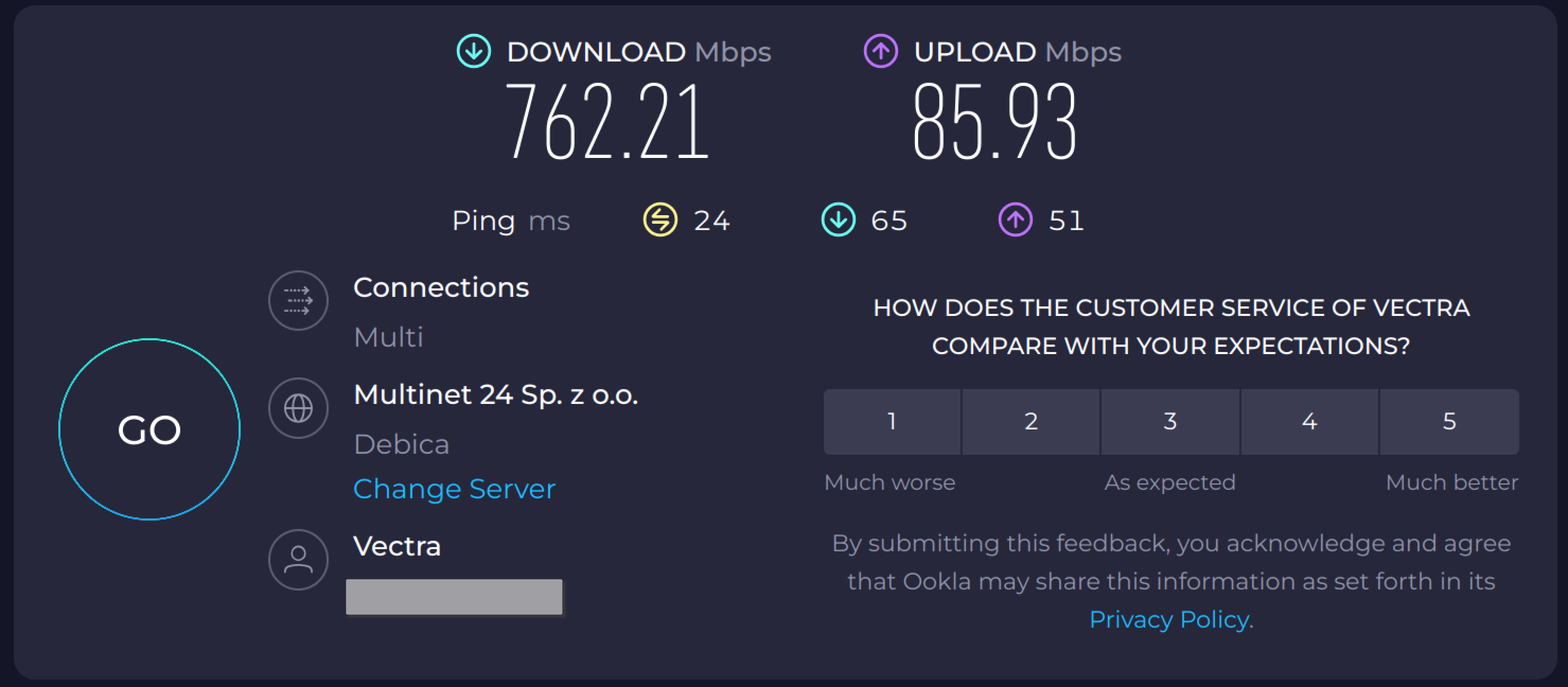

Speedtest results

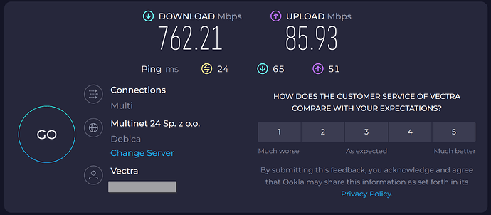

This is where things get interesting. Running speedtest in Chromium yields
But running via speedtest-cli on the same server immediately before/after the chromium run yields much lower results

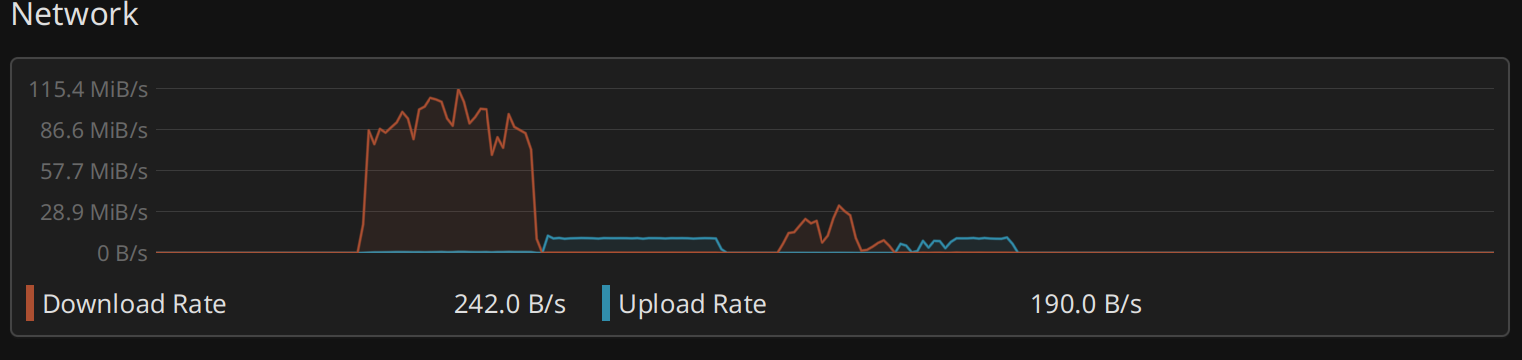

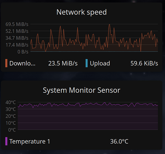

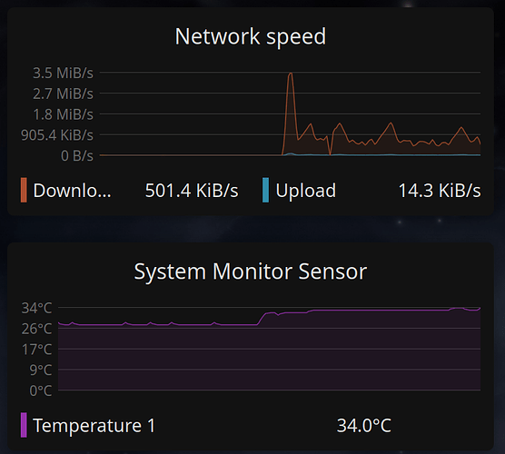

This is confirmed by System Monitor (Chromium first, CLI second)
