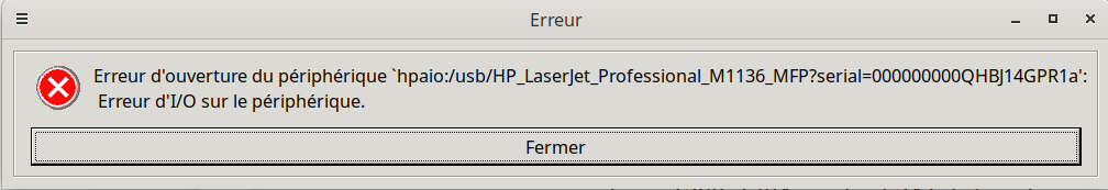

I launche xsane which provides a little more information. It detects the printer but says there is an I/O error on this peripheric.

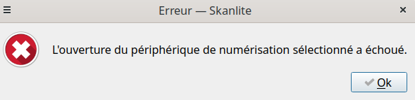

Give skanlite a try see if this works with your printer/scanner. I’ve got an old usb HP6200C flatbed
scanner and it works with it. I also loaded simple-scan up and ran it.It also worked. Is there any HP driver installation that needs to be fixed? I’ve had issues for the longest time with HP and my p1006 laser printer but it works with the HPLIP finally. It required a proprietary HP driver download everytime to get it to setup and work with HPLIP. Everything is good now.
Rich :wink:
I installed skanlite and obtained the same result as with xsane
roger@roger-lenovo ~]$ scanimage -T
Output format is not set, using pnm as a default.
scanimage: sane_start: Invalid argument
