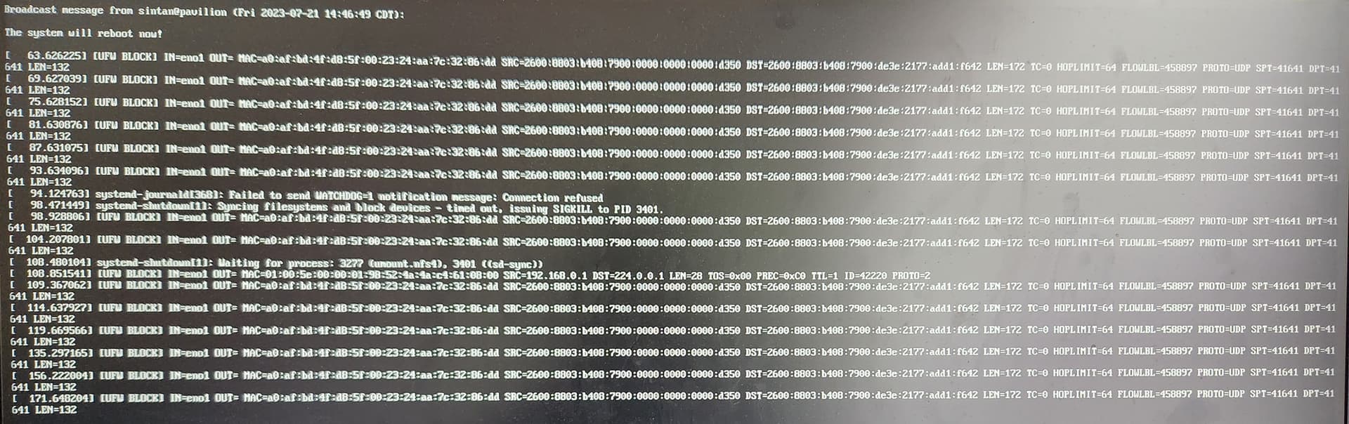

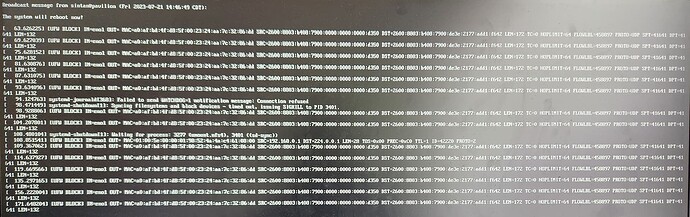

If you let it sit on a shutdown, time it. Is it about 90 seconds before it powers off or restarts? If so, there’s an errant process that isn’t shutting down that eventually gets killed.
It takes around twice that.

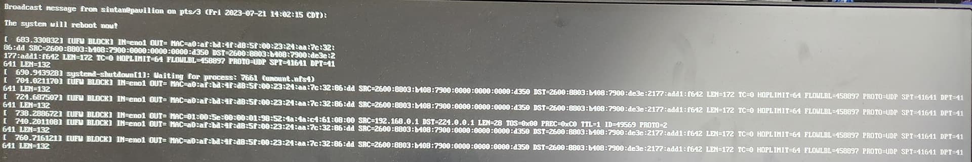

If it is hitting systemd 90 second timeouts once or twice, then they are usually visible on the console as the shutdown proceeds? Since you didn’t provide a comment or picture relating, I guess that you don’t see this?
Maybe you need to shutdown kde/plasma and revert to multi-user mode before starting the shutdown?
sudo systemctl isolate multi-user.target
will kill graphical session and switch to multi-user where you should login to root, or login to your account and then sudo -s, then you can use
shutdown --now
and hopefully you will see if systemd is timing out some units, and thus what they are, since they won’t be in the log because systemd-journald was already shutdown.
I think we’re on to something here. I got
[15342.335923] systemd-shutdown[1]: Waiting for process: 102370 (umount.nfs4)
I have an nfs4 mount, mounted via autofs. That’s probably the cause of this. I tried running
sudo umount -a -f -t nfs4
before shutting down and that seems to get rid of this delay.

Also, the port 41641 mentioned in the UFW BLOCK messages, is supposed to be related to tailscale, which is part of the autofs mount setup.
