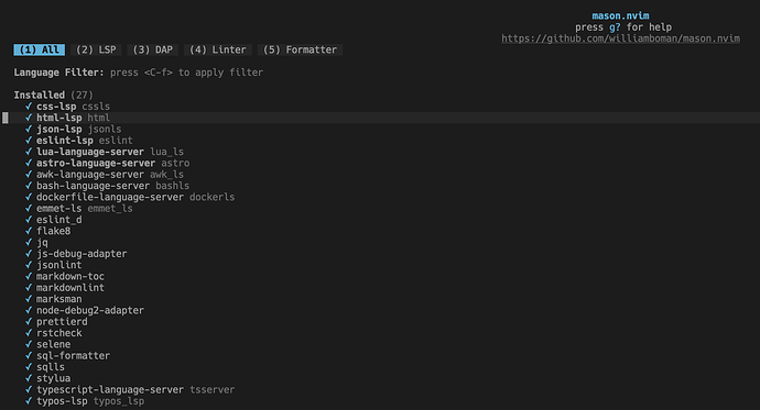

Got to give a shout out to Astronvim. Ever since NeoVim moved to lua it has been config hell for me. Stopped trying to roll-my-own and tried LunarVim, nvChad, and others. Astronvim was easy to setup and did 99% of what I needed to do with minimal config.
I have some oddball needs since I work with some old Node.js API’s that use Mocha. Setup under Astronvim was incredibly simple setup to allow me to run/debug tests in the editor. Goodbye vscode!
only thing changed from install were mason installs and two files
