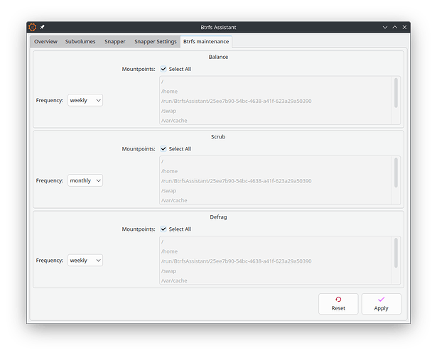

I would probably use btrfs assistant + btrfs-maintenance, is there a better tool that will alert me if there are errors?

I thought btrfsmaintance took care of this?
