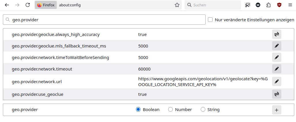

Once you know which geolocation service to use, you should go to about:config in Firefox (type it in your URL bar). Change geo.provider.network.url to your location api.
In Mint, for example, they use
https://www.googleapis.com/geolocation/v1/geolocate?key=%GOOGLE_LOCATION_SERVICE_API_KEY%
for the geo.provider.network.url. But don’t ask me where %GOOGLE_LOCATION_SERVICE_API_KEY% comes from.
(Without telling me. Hmmm.)

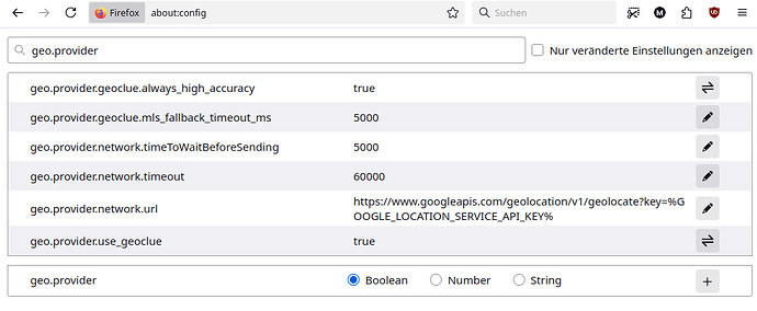

Just quickly cross-checked with an EOS machine here, seems the same:
That is interesting. Where does the %GOOGLE_LOCATION_SERVICE_API_KEY% come from indeed?
And what are the other geo location services that can be used instead of Google Location?
